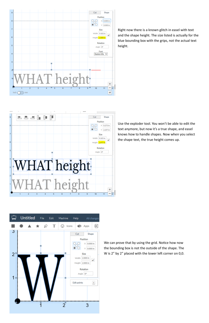

The straight bit cleanup is a little hard to see i put a pencil next to where the tops of the letters were cut.
I have also attached the settings for vcarve and the Vcut itself just for reference.
You can see where it cut the top of the P off and the top of the L off . its is kinda of fancy font (thats the reason i attached the vcarve picture for reference).
Thanks Again!!
