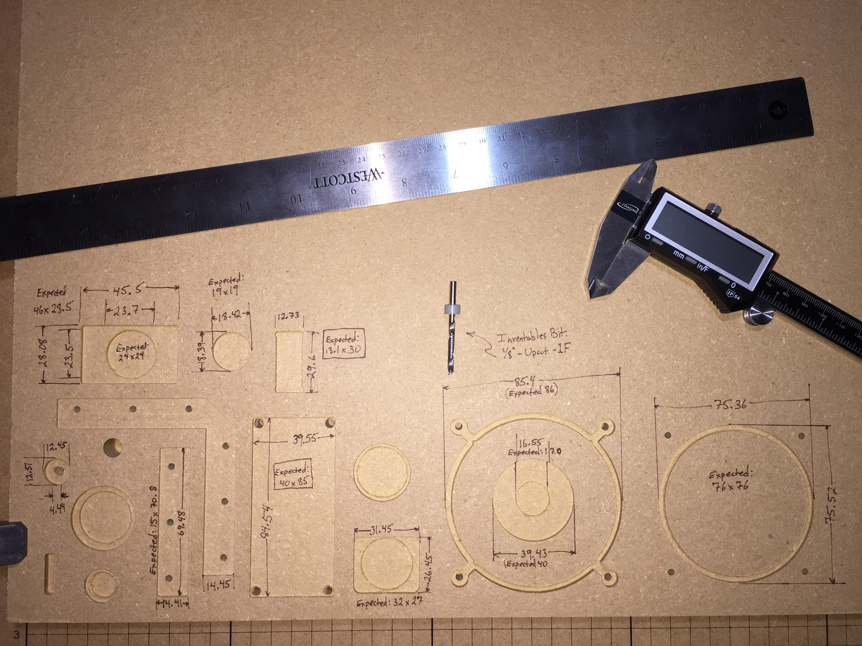

I ran another test this weekend, this time just using the Inventables 1/8" upcut bit (grey collar). It looks like every cut is consistently .5mm short (taking into account acceptable operating tolerances).
Since I’m fairly new to all this and don’t have a lot of past experiences to draw upon, is it possible that backlash and/or deflection could really produce a consistent .5mm discrepancy?
Is there something mechanical I should be adjusting? Belt tension? Controller voltages? Feed rate? Router (Dewalt 611) RPM?
