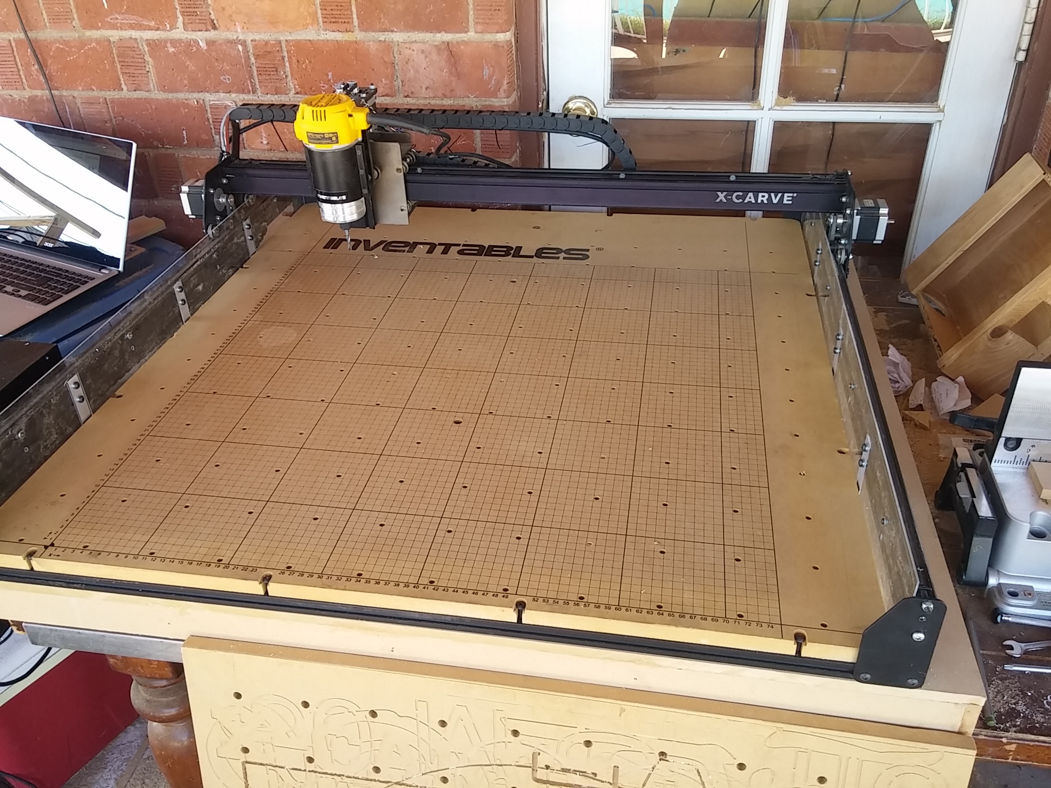

Finally got around to doing some upgrades
I finally got around to stiffening up my machine very happy with my results. I used 1/16 aluminum and acrylic for the y 4 mm bolts for the x axis and built a tortion box out of 1/2 mdf for the base. The machine is bolted to the tortion box with 3 2 bolt 90 degree angle brackets from inventables on each side. I also built a new enclosure for the electronics. The fan vent that’s over the arduino is the elemental model of aluminum :slight_smile: which I now can cut wonderfully! Hope you all like what I did
