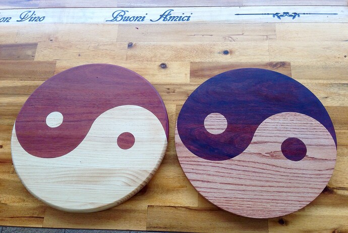

Tried making two matching pieces to glue together. The wood is Pine and Jarrah (smaller strips glued together). Came out reasonably well - except I didn’t line up the grain on the circular inserts, D’oh! Think i’m confident enough to try this now on some solid (and so more expensive) pieces of wood.
I’d be keen on any suggestions on finishing off the edges (other than using a roundover bit) to make them a little more interesting.

I think Jarrah qualifies as an expensive wood :grinning:
Looks good.
I think the round over fits the piece perfectly. Nice looking piece.
I agree, round-over fits the theme nicely. A chamfer is the next choice. It will leave a “corner” all the way around the piece and a sharper shadow line. It was nice that you caught the grain thing. I even align grain on 1/4" plugs for screw holes.
BTW, it looks like you got the most difficult/important aspect of your project right, the pieces fit together perfectly!
That looks great as is, you could probably do that with pine and red oak (or pine and stained pine) and have it look good. Is there any chance you did this in Easel and are willing to share the project? :smile:
Knock a 45º chamfer in that bad boy and it’d be perfect.

@Mike nice work.
The vector I have, for whatever reason, needs to be cut using each half. If I duplicate one half only, the fit isn’t seamless - mind you, I still had some serious clamping force going on when I glued things together.
I rarely trust things I find on the internet to be truly symmetrical or centered or anything… Unless you drew it yourself you just don’t know how it was done. That’s why I did my own. That said, these machines aren’t 100% precise either. 1 missed step during a cut, or a couple of thou of runout in the spindle multiplied over both pieces can cause some gaps to show up in an otherwise perfect file.

@Mike heres one made with your version (your file produced the one on the right). The one on the left is Jarrah and Pine, the one on the right is Jarrah and Red Oak. I used a round-over bit on the left one, but haven’t yet decided what I’ll do on the edge of other one (if I do anything at all).
I need to keep trying different timbers; the Jarrah is beautiful and relatively cheap (I’m in Western Australia where it grows), the pine is easy to work but is way too soft, and the Red Oak, while reasonably hard and nice looking, is a pain to try and sand flat & smooth.

It looks wonderful! How well did the pieces fit? Was there still a lot of sanding to do?

@Mike they needed some sanding and some really strong clamping to get the two halves together.
To prevent the ‘tails’ from breaking off, I joined a bunch of hose clamps together to make one clamp large enough to encircle the entire thing. This was progressively tightened, whilst I also used bar clamps to pull the two halves together. G clamps were also used to hold the two halves flat against the bars of the bar clamps (if that makes sense).
I like your version of the design because the curves are smoother and the “eyes” are a little larger. This time at least, I managed to align the grain when inserting the plugs.
Finished product is 400mm (16") in diameter. I’d go larger, however I’m already having to edge-glue planks together to get timber wide enough and until I get a router table so I can finger joint or mitre joint the edges, I think I’ve kinda gone as wide as practicable for now.
