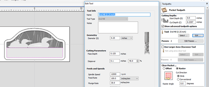

The entire model is being considered 3D. Unless you ‘really’ need the bevels on the inside of the pockets and the outside of the piece (why not just use a hand or table-router for outside bevels?), then a good option to consider for reducing the time is using a selected vector to only carve the pocket with the 3D Finish toolpath.
When you have the 3D View open, and hover over the area where the bottom part of the pocket is, where you’d place your text, it will show you the Z dimension in the status bar at the bottom of the window.
Then, just make a new vector and setup a standard raster-pocket cut at that depth.
Make sure your bit protrudes from the bottom of your collet to clear your top edge. The bottom of that pocket is 1.035" down.

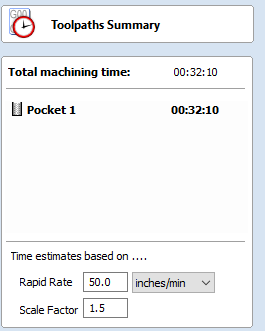

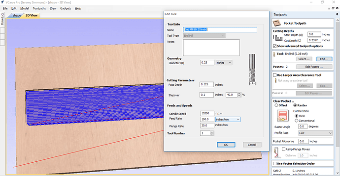

24" x 4.2" @ 0.2357" deep, 40% stepover, 2 passes @ 100ipm. It’s ONLY the vector at the bottom, and it’s a standard Pocket Toolpath, not a 3d Roughing pass. If you can spot what’s throwing the times off, let me know.
Same pocket as the ONLY element on a carve has the same time…

I don’t think you’re using the vectors I created based on the cut preview. Are you using the CRV file I sent back to you? These toolmarks shouldn’t be on the outside for the roughing operation… this means you didn’t use the vector on the inside of the top pocket I made…
The vector you want to have selected while you generate the rouging 3d and finish 3d is on the inside of the top pocket. It’s a dashed magenta line.
