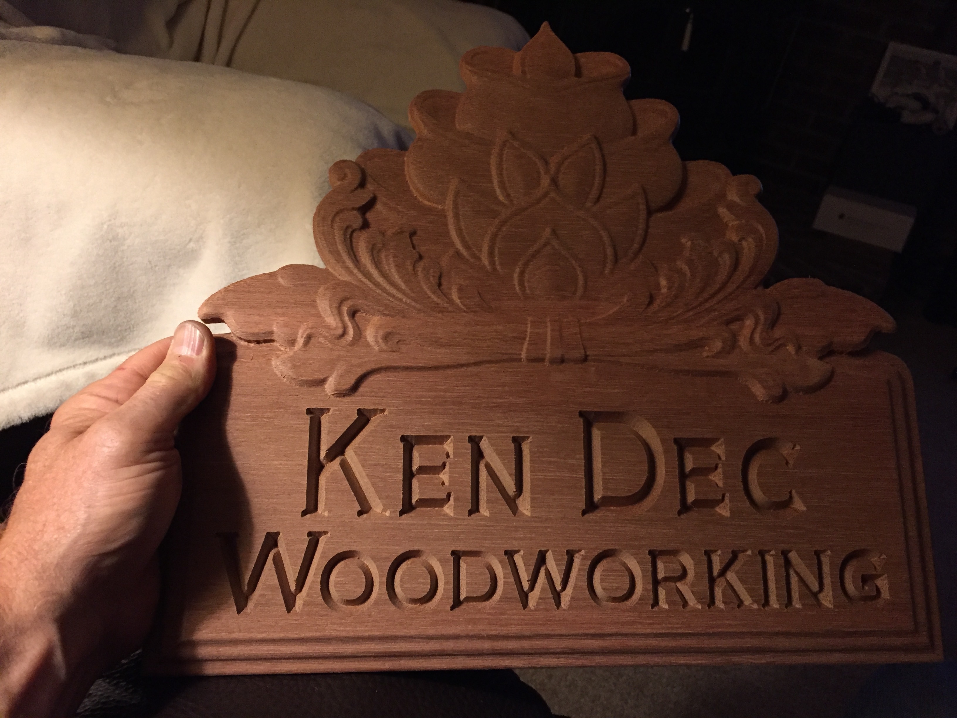

This project was based on following a Vectric Aspire tutorial. It is my first major success. (Leave it to me to start with a more complicated project) It is comprised of three components assembled and the the heights adjusted to fit the 3/4" thickness of the mahogany board. The first two efforts were a disaster that taught me the importance of controlling the dust so that the v-wheels and tracks stay clean for uninterrupted travel. A slightly loose locknut at the top of the Z axis threaded rod was easily missed but the cause of issues for sure. I ran the tool paths using raster, cutting left to right with the grain. I use a Dewalt spindle. I used a 1/4" end mill for the roughing path at 60ipm/40% stepover and a 1/8" ball nose for the finish path at 60ipm/8% stepover. I had slowed the feeds as a result of previous issues so this project took about 10 hours but the results speak for themselves. Note that 8% of a 1/8" bit is only .01" so of course it’s going to take a while. This is how it looked right off the machine with only a 30 second scuff sanding to remove some “hairs” at some of the cut edges. Soooo, all you newbies fighting through the beginner frustrations, it can be done! It will work!
