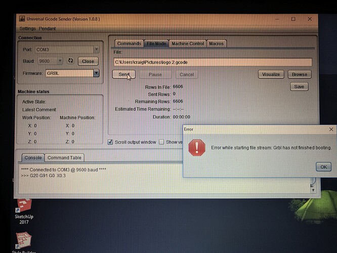

Trying out UGS for the first time and I’m getting this. Is there another step I need to be doing?
Change the baud rate to 115200.
The baud rate must be set to 115200 to connect.

Hit send to see what would happen and now I get this.
I think that message would come up if you hit the Close button and then the Open button after a send failed, because it won’t clear the stream buffer. The way around that would be to do a hard reset by hitting Close, power cycle the controller, and then hit Open.
