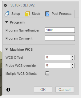

Did you zero from the top of the work piece or the wasteboard?
Under the main Setup-folder did you edit the stock material dimensions?
Default stock offset = 1mm meaning if you zero Z on stock the initial plunge will go 1mm too deep.
You can either edit Z offset = 0 or zero the Z of the material, lift Z 1mm and use that as Z zero.
I’m a little confused. From what I’m reading, you are having an issue with the holes? If that’s the case, you are running a 2D contour. It should be an adaptive clearing. Also try raising your safety hight. It’s a bit close.
I would use 2D adaptive for such an operation too.

@A_hartman90
I zero the z axis from top of the stock material.
@DennisSchell
The holes are one example from the wrong toolpath. Everything else went also wrong.
Thx for the info with the adaptive clearing. I will do that in the future.
@HaldorLonningdal
Interesting. Maybe this is the Problem.
Here is my setup.
009
011
@theguymasamato I originally thought the same as @HaldorLonningdal, but your gcode only shows the toolpath going to Z-0.1mm. Can you share the Fusion file?
