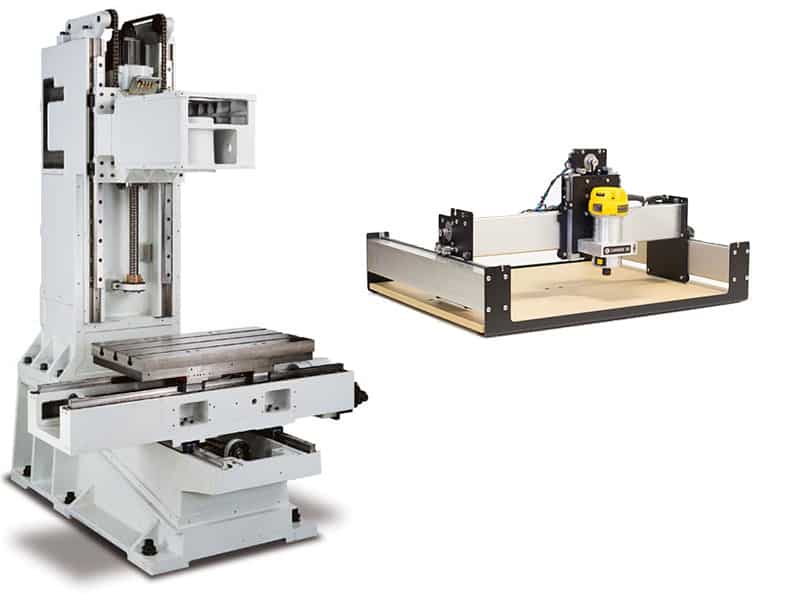

GWizard would have been a godsend back when I used industrial sized machinery. I downloaded a trial and played with it for a while, but came to the conclusion that it’s not really aimed at user of machines like ours.
By the time you make allowances for all the differences between an XCarve and and an industrial cnc, you may as well have done your own calc’s.
If I get inspired, maybe I’ll make up a calculator for the XCarve in MS Excel.
Here is an interesting post by Bob Warfield the person behind Gwizard. He has a Blog at cnccookbook.com where he posts lots of CNC related information.
Here is a link to a blog post about using Gwizard on both small and big CNC machines.
I think that folk here on this forum will find the information very helpful.
