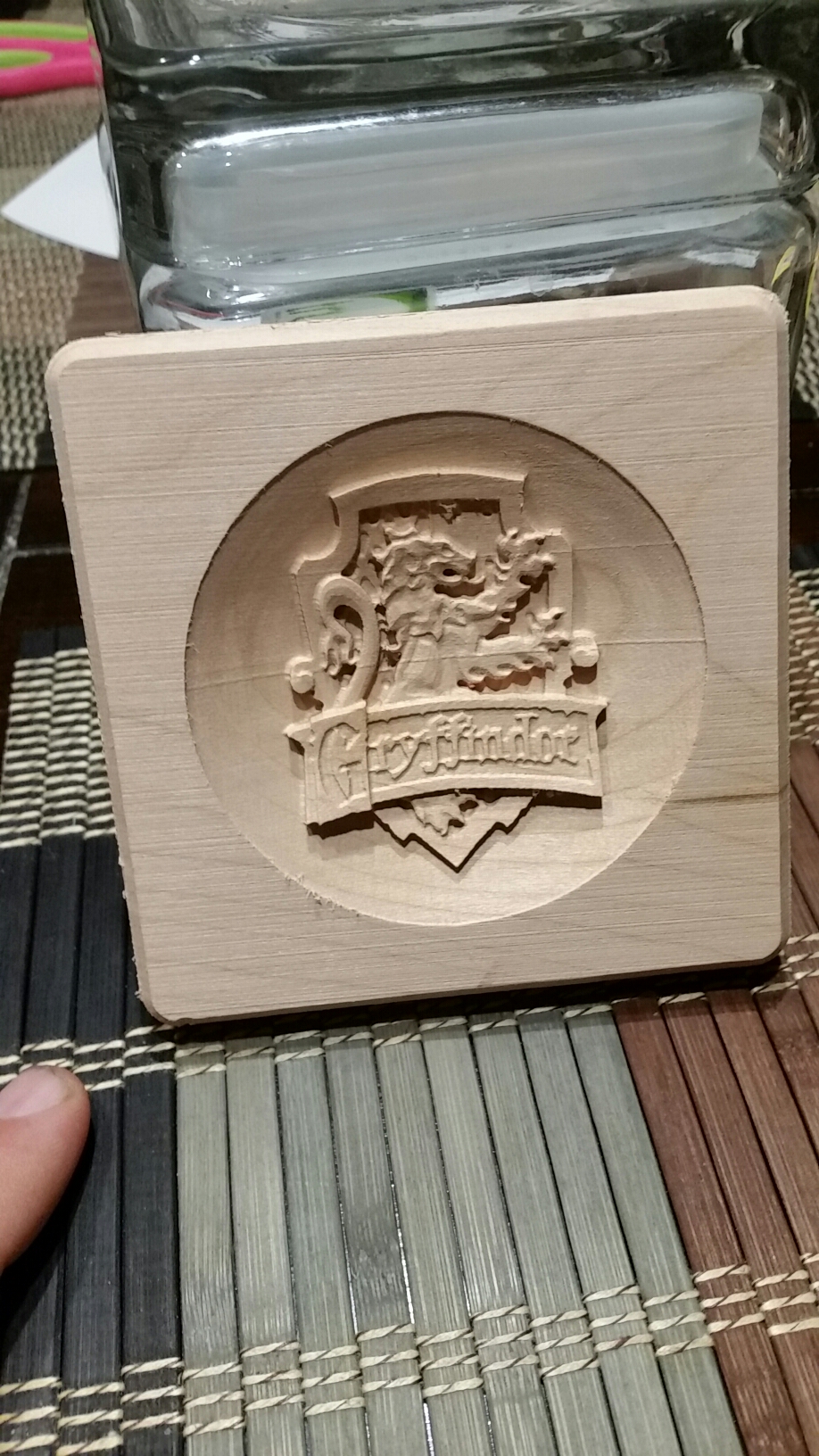

Phil got me started on 3d carving, so I downloaded this .stl and created my own coaster. A set will be each of the 4 groups. I will fill the cavity with clear CastinCraft to make it flat. Should be interesting.
I used a .5mm tapered BN bit to cut the final 3d pass. Took too long so I made some adjustments to bring down the time for the next carve. finally used my 90deg bit for the bevel. I’ve had that bit for a year and haven’t used it yet.

If you decide to fill the whole dish with resin so it’s level with the coaster body, you might want to consider a paint pot ($99 at harbor freight), it works REALLY well to get all the bubbles out. I never had luck with the heat gun approach, and still had lots of bubbles, but with the pressure cooker approach they’re like glass with no bubbles at all…

I lightly sanded it and put a coat of Arm-r-Seal in there to bring the grain out a bit. I need to be careful about sealing it too much or the resin won’t have much to grip.
I’m carving the HuffPuff coaster now but it’s on poplar ( the light wasn’t good last night and I mistook it for cherry). I don’t like how the wood just frays in some spots. This may be my experimental coaster.
I was playing around with the toolpaths on this one (Vcarve Desktop 9.0) and noticed that there is a huge difference between a BN and tapered BN toolpath. If I select .75mm BN I get a 7hr cut time, but the same basic settings with tapered .75mm BN are around 15-20 mins. I’ll get around to posting pics of those setups here in a day or so, maybe I’m not seeing it right.

Here is the final product. 1 air bubble that’s not too bad. I’m wondering if the light area’s in the tail are caused from a trapped air bubble. I’ll have to look at a vacuum pot, converting those HF painting pressurized pots makes me a bit nervous.
Pot conversion is easy, just make sure to have a blow off valve for 60psi and you’ll be good to go. Takes about 30 minutes to modify, super simple…
Yes, those are bubbles, I was battling the same thing until I started using the pot.
