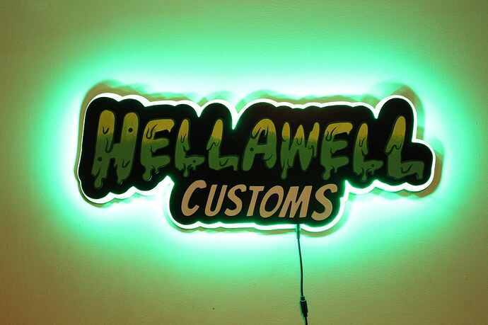

After looking at that sign, I wouldn’t mind making a sign like yours of just the words. Got any guides ? :smiley:
Thanks for the input guys!
Tons of patience and planning! Just got to look at the logo and envision it in layers. I designed my logo in Illustrator and then cut each element as a separate layer and then stacked them. I think I had 5 different easel files to do all of the work. The painting was a whole different story!
