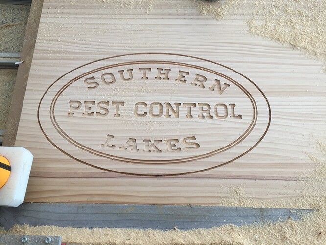

Hi there after a little help I have built my 3axis CNC and using Arduino to run it I have 3 Nema 23
running off 40v power supply. I have now got it up and running but am having trouble when I try carve or cut any thing the steeper on the y axis seems to skip or stutter it happens in the same place most times and gives me strange results when trying to run Code the answer is probably simple but I can not figure it out for the life of me . Any help would be greatly appreciated.

I do not think your current limiters are hitting max temp because that would giv you a straight line in either the horizontal or vertical plane.
The circles are deformed due to flex, if you by hand pull on the bit with say a 2kg force, what kind of deflection do you see? (Disconnect spindle power before doing so)
What kind of bit do you use?
If you insert a ball point pen or pencil into the collet, how do the circle look like then?

Hey finally good news after trying every thing and I mean every thing! I have finally fixed my machine
it turns out the only way to fix the missing steeps was to change the micro steep size from 1/200 to 2A/400 and recalibrate steep size and bobs ya uncle.
