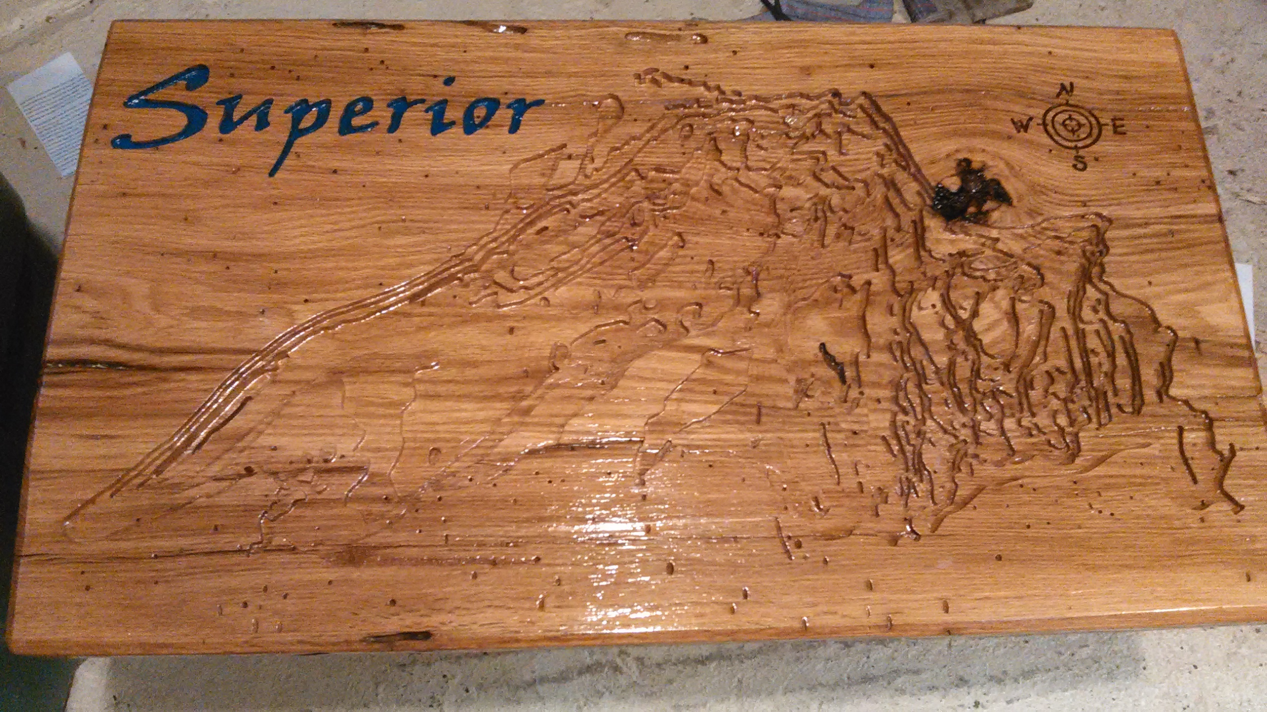

Nope. That’s not me. With a few exceptions, I’m only doing Lake Superior on live-edge oak and birch.
Here’s something I just found that might be in the same price range as yours: I did this as a gift for some good friends who let me slab a felled tree from their backyard. This neat piece is hanging in their dining room.
