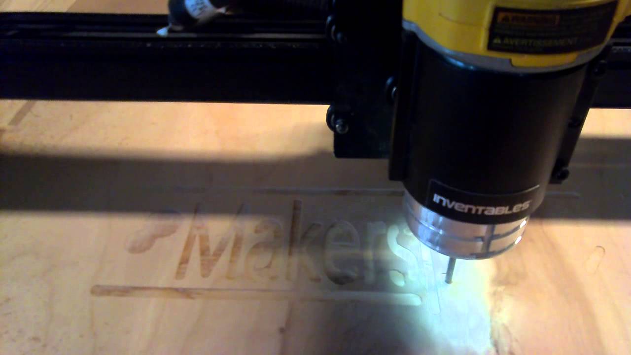

Like someone else said… upgrading from the stock " vibrator" to a cutting tool is a most. I got my x-carve 3 weeks ago… started on this…
that is mdf, took about an hour for the three pieces… rocked and rattled the whole time… lost one set due to the nuts shooting of.
then I got the dewalt 611 and mount…
I have the 611 with a 1/4 downspiral bit running 100ipm .125doc and other then still needing to adjust the pot for the x-axis it cuts like the wood isn’t there. dust collection is a must… because this thing makes chips… lots of wonderful chips.
