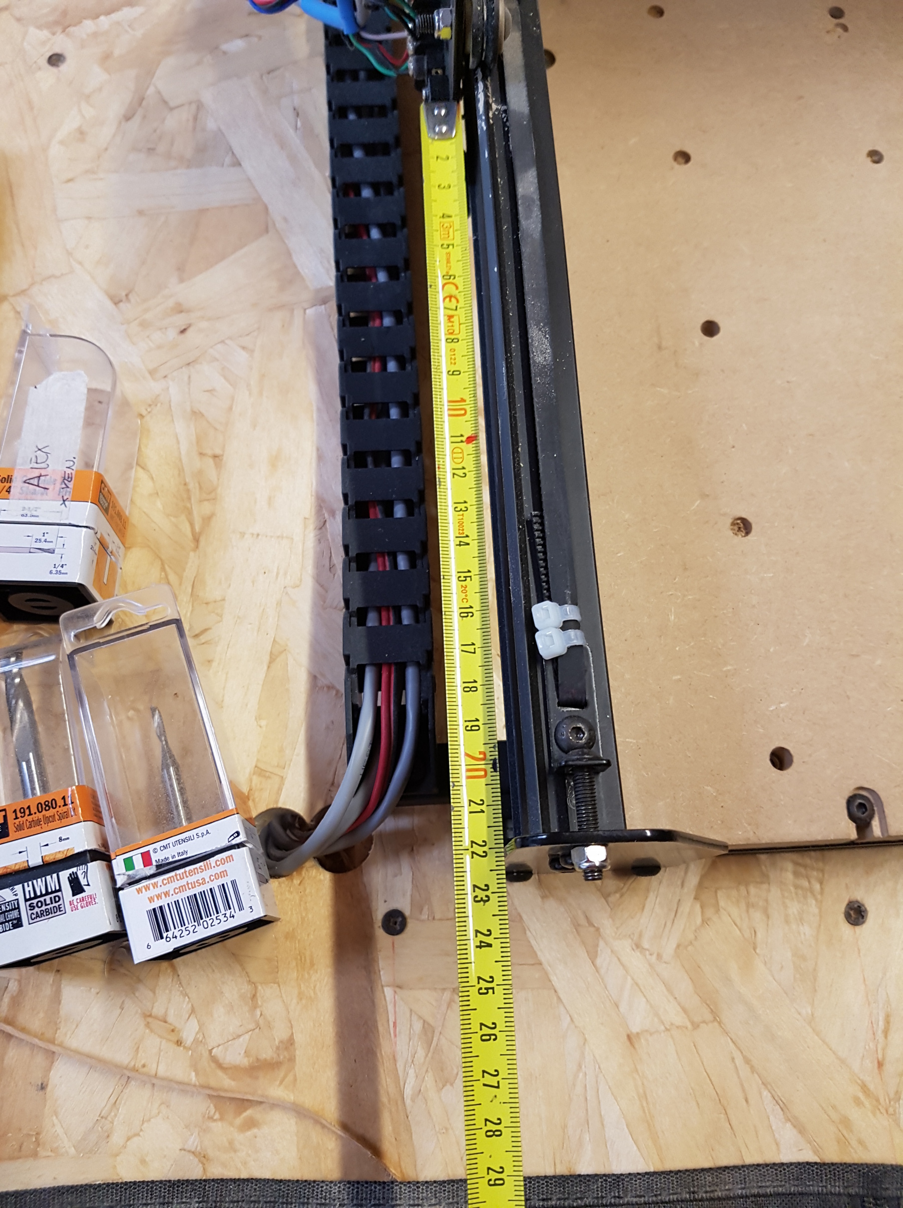

Well, while you make me think about Y axis position, EVERY time i turn the machine on I need to ‘square’ the Y axis with putting 2 identical cube in front of the machine and pulling the axis against them to make sure is squared.
I also noticed that the right side of the machine is usually a little bit forward than the left side, of about a millimiter or less.
I can assure that the extrusion is square but never found why the Y axis act like this and I always have to ‘square’ it.
I think your answer is here, if the machine changes squareness when powered down it means there is tension in your setup.
The length of the X makerslides may differ or your stiffening method mounts them into a shifted position against each other. Loosen the bolts of the stiffening bar and slightly take of the tension of the bolts in the Y gantry plate. I assume that you measured the Y squareness diagonally. Verify the position of the X beam in the Y gantry plates, measure the distance on the back. Now your Y should stay equal on both sides when joging back and forth. Start tightening everything up and see when the behaviour changes. Solve this and your machine will stay square.

This is what I have with the machine off. I simply pulled the X axis against the rule and seem like the left side move more than the right side.
Right side.
Left side
Now that I have squared it, I have 22.2 form the left side and 22.2 form the right side.
62.3 on left and right back sides, so I assume the machine is pretty squared, right?

Thanks for the pictures. Next step is to measure from the left back corner to the right front corner and compare this with the distance from the richt back corner to the left front corner. This should be identical. This needs to stay identical so you need to fix the machine to the table.
You can start by bolting the back to the table and then slide the front 20x20 beam in such a way that the diagonal measurements are identical. Then attach bolts at the front.
