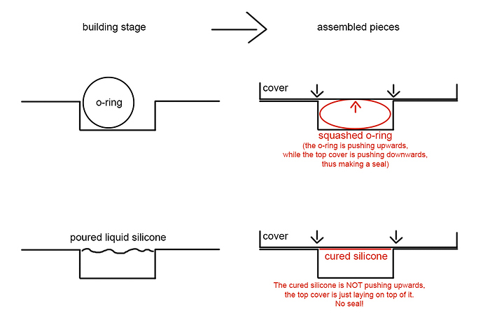

You could also use sealant (silicone or similar) to form your own ā€œringā€ by gluing it into the base groove, and using a separator film (cling wrap or similar) to avoid it bonding to the top piece. This mill make a removable top piece with a fixed seal on the base part.
Basically fill the base cavity with sealant, add a separator film or agent to top piece, assemble with almost no pressure (maintaining approx 1mm separation between base/top part and let it cure. Remove top part and separator, reapply top piece and secure it to its desired firmness.
You could also make the slot for the O-ring to a different circumference, tailored to available sizes, both in length and in thickness.
Just another 2cents worth :grinning:

Yep i thought about making the seal by filling in the groove like a mold, but i see some problems with this. Hereā€™s what i mean: (by the way, i have NO experience with silicone, so these are just my ideas and could be totally wrong!)
Basically, a seal is created when the o-ring is pushing against the top piece. At the same time, i canā€™t let any space stay in the middle after securing the top to the bottom piece, the two pieces must look like they were bonded, so the o-ring should be a little bit taller than the groove, just enough to squeeze when pushed down, fill the groove width and go flush with the top of the groove. The cured silicone wonā€™t push upwards because it wonā€™t be taller than the groove after curing and thus would not be squashed down by the top piece like an o-ring, and would also have zero space to squeeze and fill the width of the groove.
I donā€™t know how to 1) have the silicone cure 0.5mm/1mm taller than the groove height 2) have the silicone not fill the whole groove width when poured, so to have some free space for the silicone to squeeze when actually securing the top piece.
Again, these are just my ideas, i may be wrong!
Yes indeed! but iā€™m looking for a very high quality cut, and iā€™m not that skilledā€¦my hand cut would simply look bad. I also thought about milling a sheet of some rubber, but i fear the x-carve and the router arenā€™t the best tools for such a job, as you also said, the best tool would be a knife cutter. I fear an end mill would rip the sheet apart.
The silicone (or similar media/sealants) need to be oversized, that is why I mentioned leaving say a 1mm gap between the parts for the curing stage. Once cured you can attach the top piece firmly, the 1mm oversized (in height) silicone will allow a proper squeeze/achieve seal :slight_smile:
You mean that while curing, the silicone will raise 1 mm above the top of the groove by itself? or that i should put a 1mm routed mask to allow for a taller height?
And how would you go about leaving free space in the width of the groove so to allow for some squash? When pouring the liquid silicone, it will fill the entire width of the groove, and when attaching the top firmly, the silicone will not have room for squeezing.
Silicone wont increase in size, however it is solid enough to not flow much in its uncured state.
So using 1mm spacers for the curing stage sound easy enough.
Silicone do not flow much uncured so making it undersized for your gasket groove seem easy enough (in my head :grin: )
:smile: but that would require 2 more pieces:
  1. a 1mm thick routed mask to ensure a slightly taller silicone mold
  2. a 0.5mm (or whatever) spacer running all along one of groove internal sides
    and then i should find a way to firmly secure the spacer to the groove side before pouring.
    sounds pretty messy :wink:
I think either cutting a gasket from a rubber sheet or using a silicone/nitrile cord with larger values than what i tested to make a cut-to-size o-ring is the way to go!
