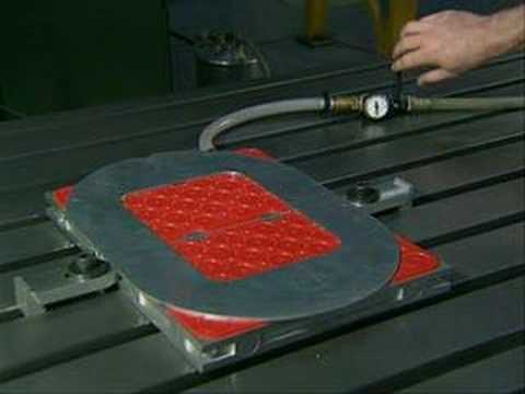

I am carving some detailed maps into thin 3mm oak 300x200mm and struggling to hold the workpiece down. The carving cuts right through the piece so I end up with bits flying off, which inevitably damage the carving sometimes.
Anyone have any ingenious solutions I could try to help me out? I thought a vaccum table might help but i would lose suction as the carve progressed.

That vac table product is pretty cool, but can only be used once if you cut into it, so not the cheapest solution! I still would like to get one someday though.
