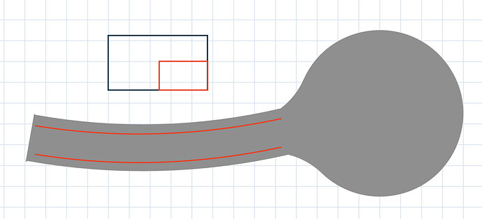

How do I make easel do a T-slot cut? I need to cut the shape in the photo with a T-slot on both of the long sides (where the red lines are drawn. It needs to be a 3/8th overhang. The rectangle is a cross view of what it needs to look like on the one side and a mirror image for the other side.
Making these in easel is typically accomplished by carving 2 seperate pieces and then gluing them together.
Setting up a toolpath like that in Easel isn’t easy by any means…
You could place a 0 depth item (like a rectangle) over the round part of that design and then setup the design to be a “inside shape path” cut type and preview the toolpath and see if it’ll do as desired… I’m not sure if that would plunge in exactly where you want though…
