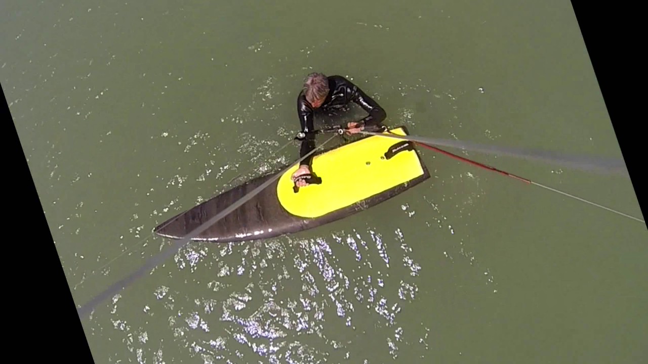

So far it worked pretty good. This is my prototype, so its not as good as the commercially available hydrofoils available. But I got some rides in.
Next I will be redesigning a lower aspect front wing. This, along with a longer, better fuselage should make a much steadier ride. An issue with the old windsurfer as a board is the convex deck. This makes it harder to prevent roll. It was harder to apply pressure to the board to keep it from rolling sideways.
I will be building an entire new board from scratch. This includes the mast (vertical strut) which is far too flexible, the fuselage, and the front wing. I think the stabilizer turned out perfect, so I may not need to make a new one.

Can’t like this enough. Awesome shots. Congratulations on building your dream!
Definitely one of the coolest things on this site! Thanks for sharing! :sunglasses:
Nice vid and idea!
the howl from the wind through the lines is haunting, I might use it for halloween this year
This gives “getting it up” a whole new meaning!
