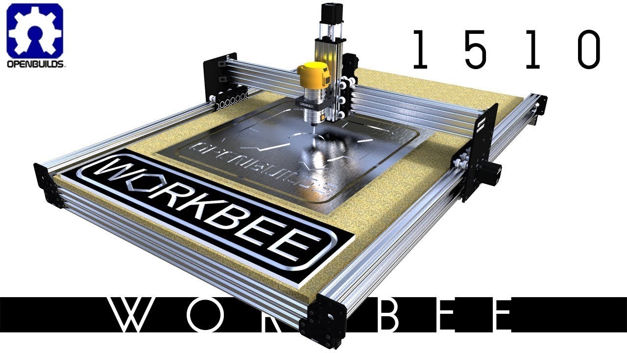

I have heard the same complaints from many other X-Carve users, which is why I gave you all those YouTube channels to check out, in the hopes you could find solutions to your problems. If you want to, and are still able to, send that machine back, here is a link to the Ooznest Workbee 1510 which has a much stronger frame, and a larger work surface than the X-Carve, and they cost about the same as an X-Carve. They also have plenty video tutorials on YouTube to show you how everything is supposed to go together. This is the same machine that I am planning on buying, hopefully by the end of the year. I have also not yet read any negative reviews about this company.
