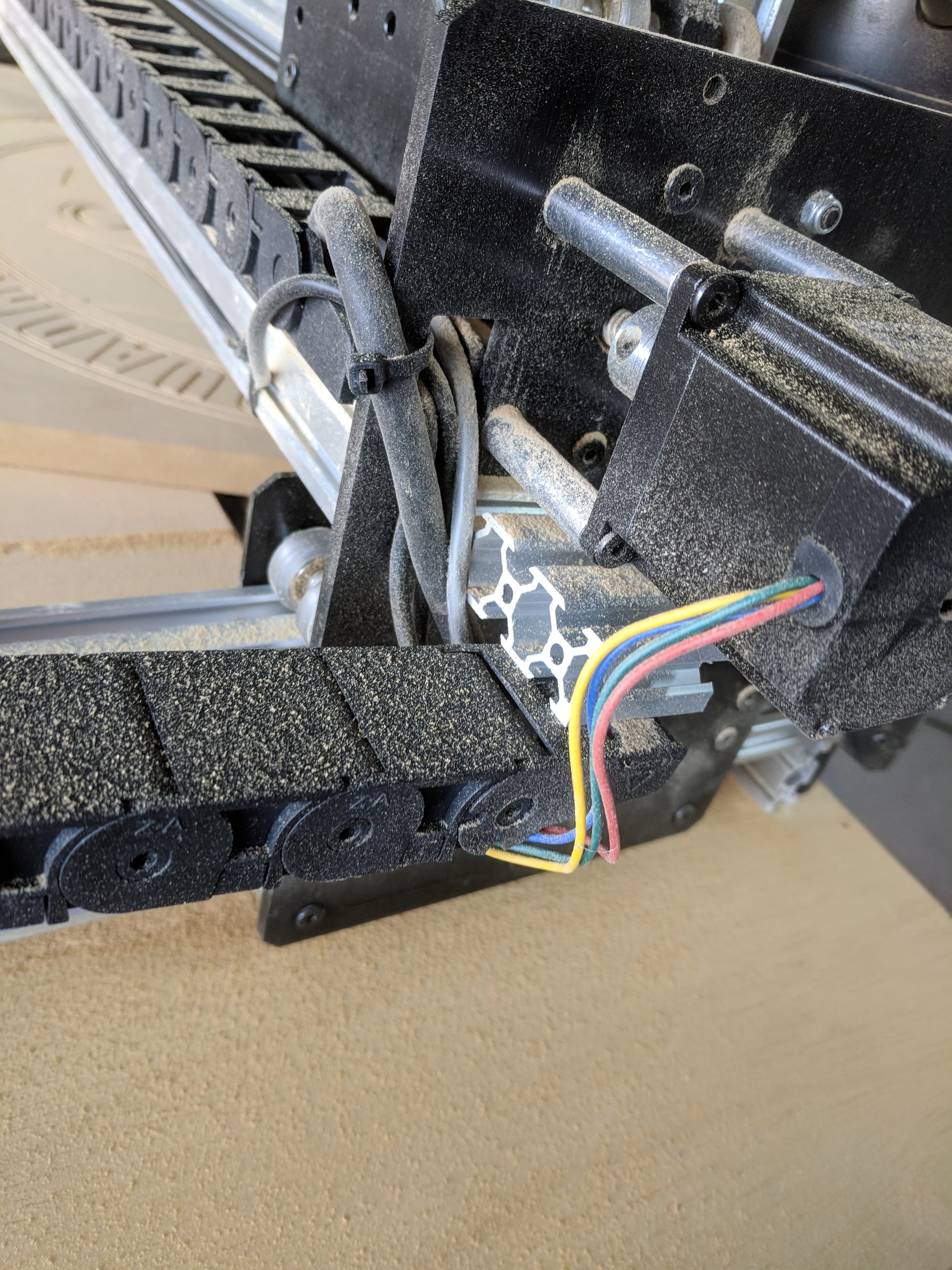

I have been over this mechanically a few times and I am using conservative cutting speeds. I ls there a possibility that there is an electrical issue? Could these unshielded wires be an issue, or maybe I’m getting some noise because my router power cable is going through the chain?
This is really beginning to look like an electrical issue. Some sort of interference or signal loss is causing it to lose steps.
check all of the connections, as well as all of the pins in the connections.

Zach, it is a workbee CNC, basically a screw driven OX. It is powered by an X controller using easel. I will take a look at the electrical connections.
Ok, I turned the juice up on the pots and I flipped the MDF for another go. Let’s see what happens, wish me luck.
BrianJohnson is the smartest man in the world! The pots needed to be turned up. I will finish cutting it out tomorrow but the carve is completed.

@PhilJohnson they are matched to the X-Carve set up but he is using an Ox so it makes sense to me that he would need to adjust them.
