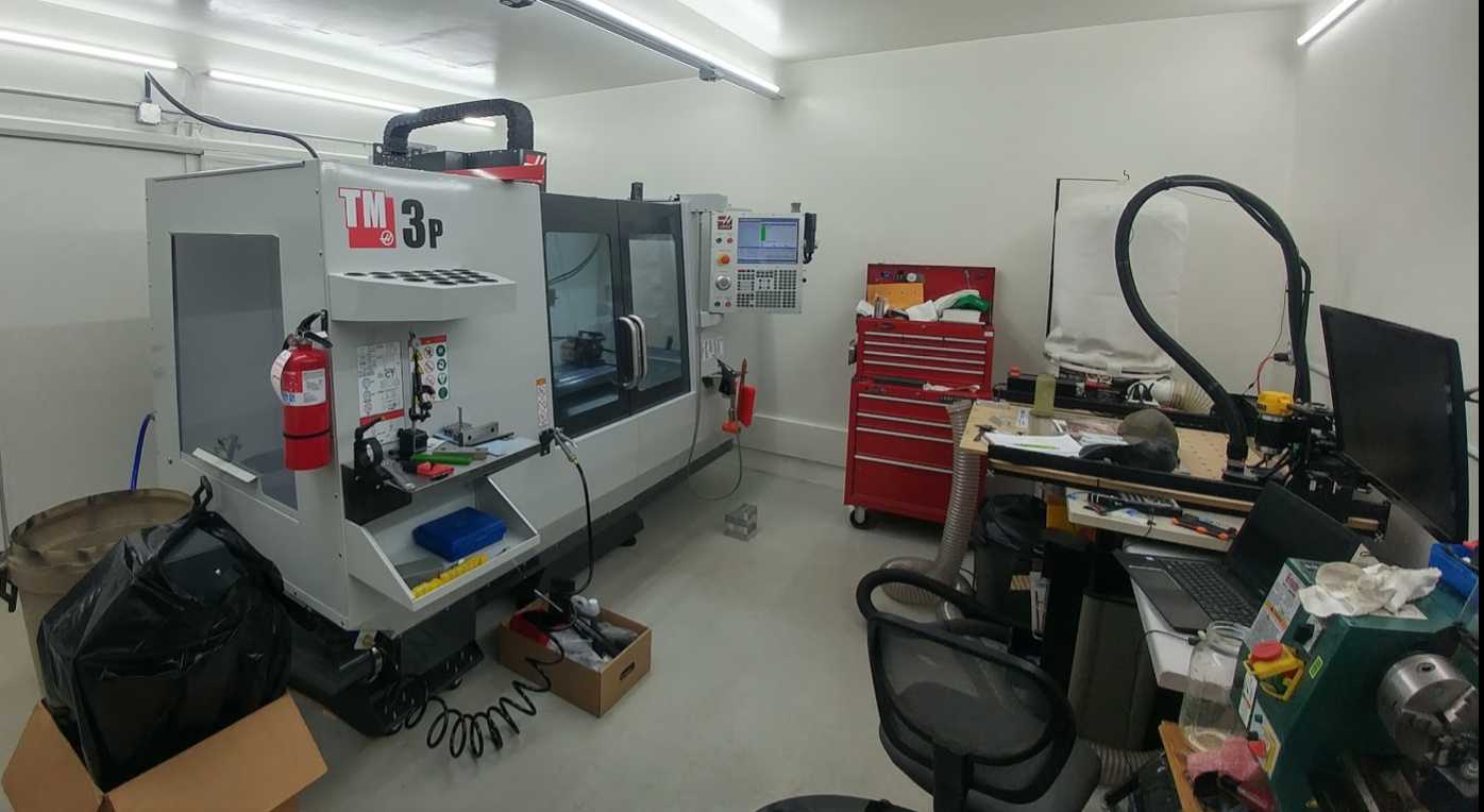

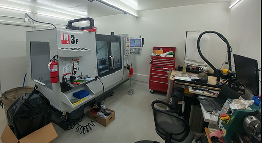

I recently purchased a Haas TM-3P toolroom mill for myself and am now running my self through lots of different set ups and learning how to optimize my tool management, offsets, cutting parameters and strategies like thread milling and 4th axis etc. And even though I have, what to me seems like the Saturn V of CNC machines in my shop I still use my x-carve quite a bit. There are some things that are just way easier and faster on and x-carve.
