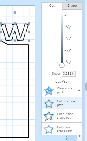

Looks like you might be cutting “on path” instead of outside.
It doesn’t cut out
Off the path
Pieces. Outside
Are you using Easel? as Neal suggested how do you have your object set to cut?
Yes cut Outside shape path
