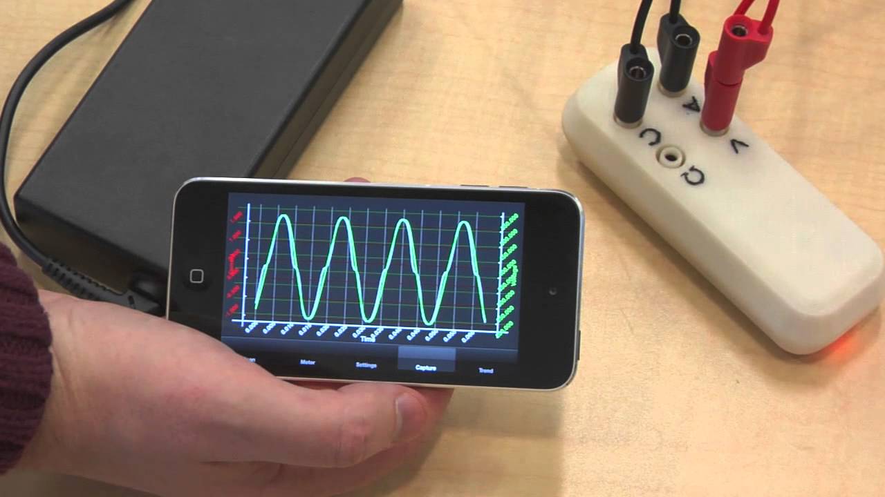

These days they’re relatively inexpensive so there’s no excuse not to have one in your toolbox. The Mooshimeter will even turn your iPhone into a cool multimeter.
