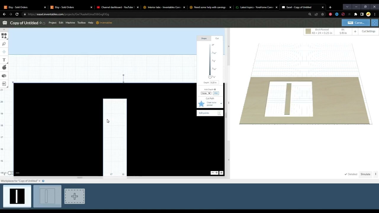

I’m trying to cut out a square base with a slot in the middle, the tabs show up on the outside just fine, I need to put tabs on the interior slot, how do I add them.

something like this
click on the vector you want tabs on, you will need to cut through the material for the use tab option.
When cutting out my material; I always change my tabs too .50 long and 0.10 height. This modification can saved my pieces from being dislodged during the carve. The original settings are set at .25 long and 0.080 tall, it would be nice to have the option to preset our tabs for further projects.
