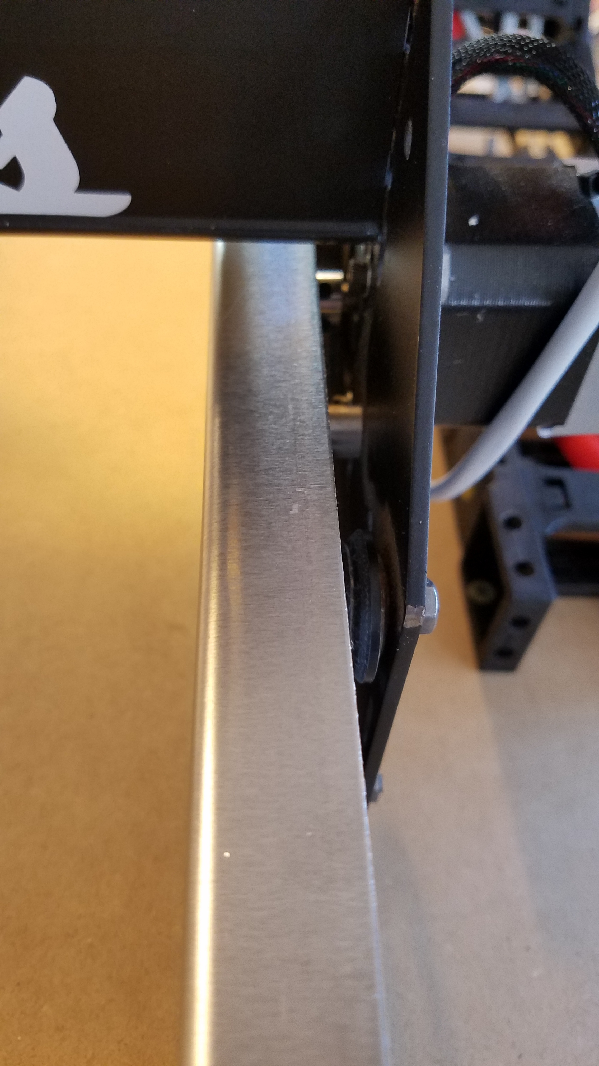

This is my favorite mod. This stiffens the rails while keeping most of the flying chips off the rails. They will bind if you get too much buildup on them.
