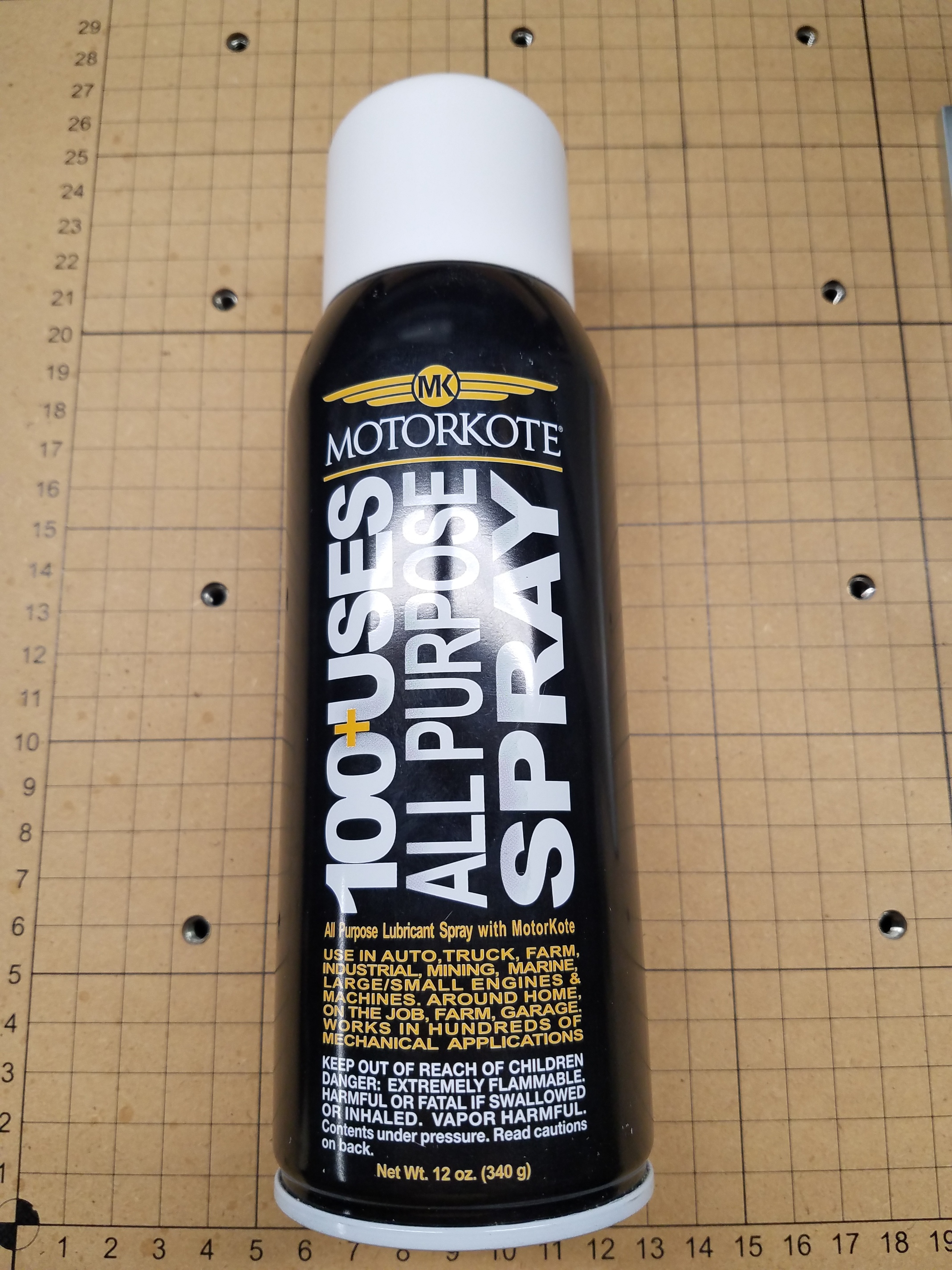

Is Motorkote good to lubricate z axis acme rod
People mention using a dry lubricant for the z axis acme rod. I have a can of Motorkote in my shop, wondering if it is suitable?
I did a test spray on scrap aluminum, it seems to be a liquid out of the can but is dry almost immediately, fully dry after a single pass gentle wipe with a rag. I’m just scared I’ll gum up the axis if I use the wrong stuff.
Appreciate if anyone has experience or advice to share.

Seems like no silicon. There is no ingredient list, but in first aid section it lists heptane, petroleum oils, n-butane, propane.
Also says don’t use on low grade plastics, not sure of the grade of delrin.
Going to err safe side and leave the Motorkote on the shelf.
