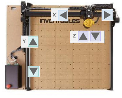

I have just finished assembly of my xcarve.
I have confirmed all the wiring is attached correctly, but I am having issues with the testing phase of set up.
My X axis moves left to right and vice versa with no issues.
However, my Y axis only moves on one side and the same with my Z axis.
They seem to be sticking or shuddering when moving as well. Sort of like they are walking. Its not fluid.
Is this only due to the wheels needing adjustment?
