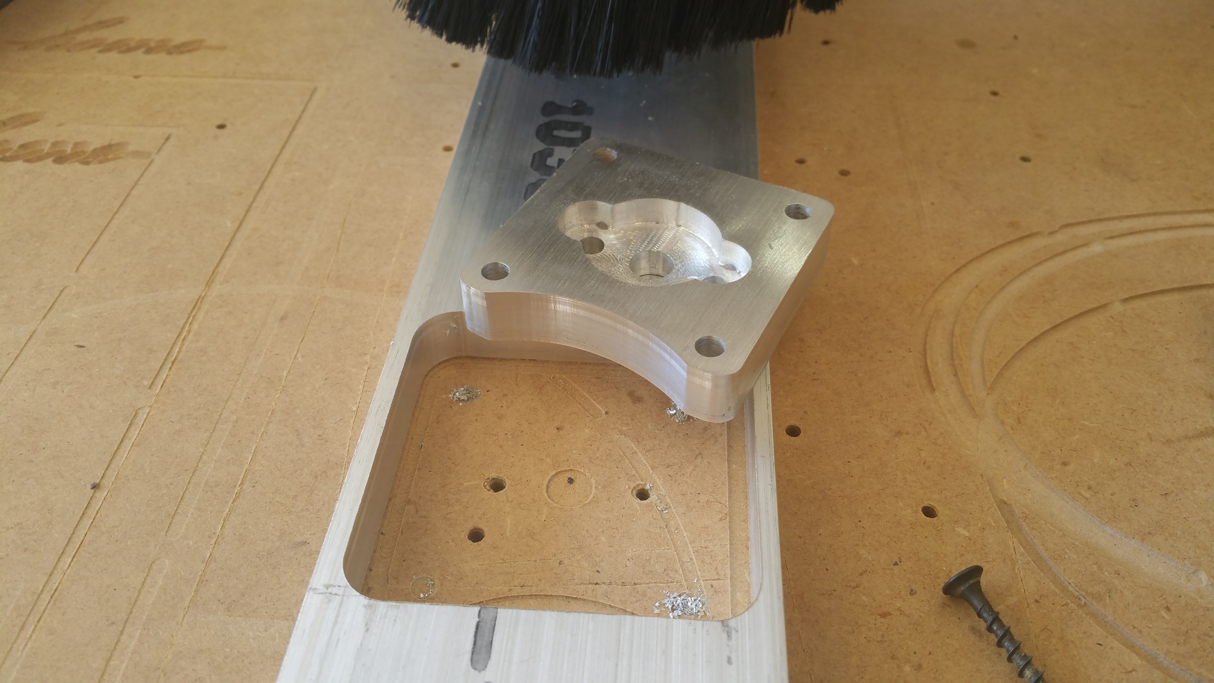

I am going to remove the pulley and belt from my Z-Axis and go with a direct connect from the stepper. First step is to cut a spacer for the top of the axis out of 1/2" aluminum. The curved front is so the Dewalt doesn’t hit the motor mount.
I used a 1/8" endmill with a titanium nitride coating at 50 IPM and a 0.5mm depth of cut.
