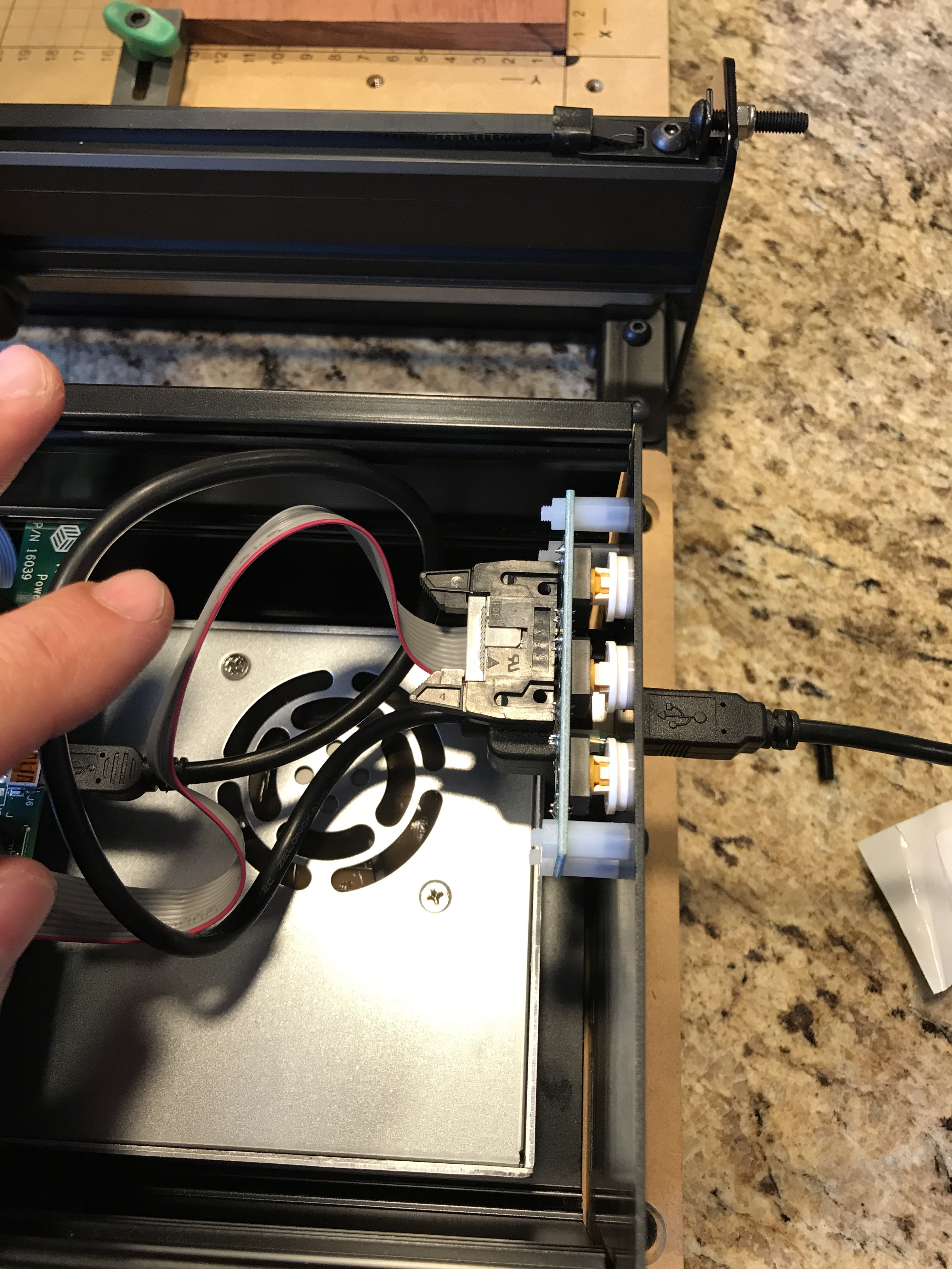

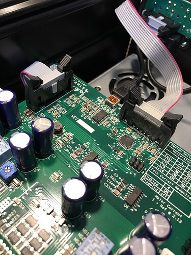

Can you start taking pictures of your connections? With no power lights and no stepper motor engagement it sounds like it is with the controller/connections and the computer doesn’t play a role
:joy: yes… One of the first things I looked at.
Your ribbon connectors are not fully seated in their sockets.
I tried pushing them in further. That’s all they go. The clamps clipped on them. I disconnected al of them and reconnected them.
