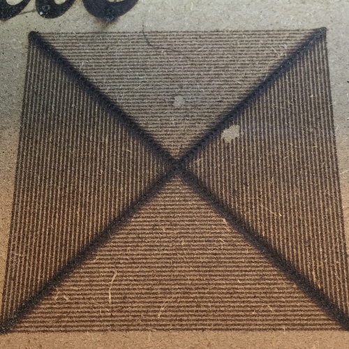

Also need to work on proper focus and height, and maybe GRBL acceleration… That will fix the X mark. Basically the machine cant turn hard square corners fast enough! Realistically this will be less of a problem with real world designs.

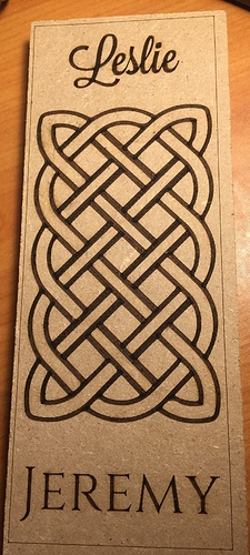

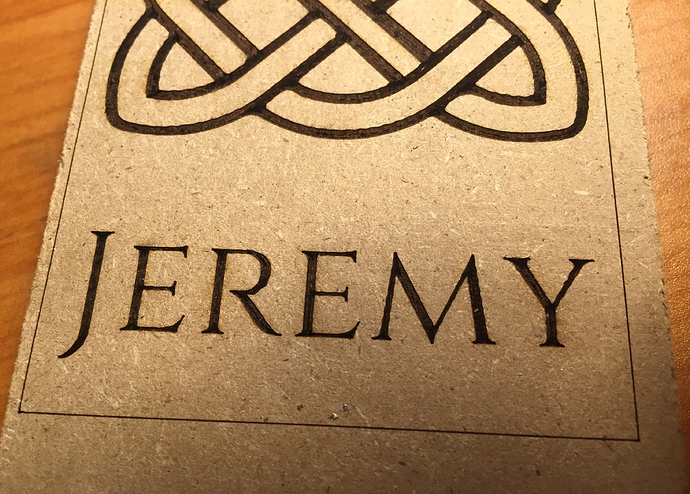

The laser is working great.
Quick demo:
Tool diameter was 0.01".
Feed rate was 80 IPM.
Took 21 minutes to burn.
Looks great.
