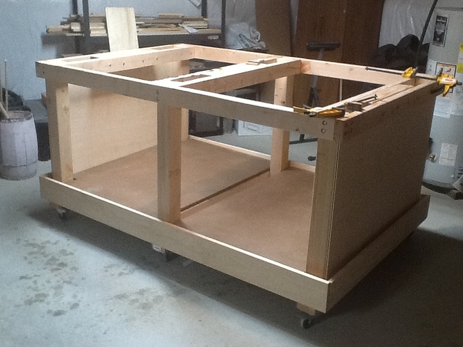

Looks like I got a problem to solve! Any ideas how to fi
Is it the entire table or just that corner?
Does it at the other corner to. Almost dips dowb in the middle. Not sure. I’m not a woodworker but I’m assuming this isn’t good.
Is that a torsion box table?
From OP’s pictures I gather he has buildt the torsion box internals only and now wants to glue the top board.
Discrepancies now show indicating and/or twisted internal structure / surface plate (3/4" MDF)
MDF is very subjective to change in humidity and if exposed to high humidity can warp/expand and not fall all the way to original state again.
In order to ensure a twist free torsion box one must:
1 - ensure a level internal structure, check with long straight-edges, on all planes and diagonals
2 - Glue the top surface onto the internal structure laying it top-side-down, on a level surface.
3 - Before glue sets flip over and glue bottom skin. A torsion box require both top and bottom surface.
4 - Let it cure completely before mounting it all.
(2B) - make holes and installtube for running hidden power/signal-wires if desired.
2x2" with top skin alone wont be rigid enough for a stable/warp free top surface.
ThIs explains everything I did! Thank you for the info. I was originally not going to add a bottom mdf but I guess from suggestions I should!
Now with the warp issue do I just glue and clamp the mdf down so that it sits level to the 2x2’s?
In general:
The idea of a torsion box is to have two parallell surfaces (top and bottom sheet) separated in distance by an internal structure. The two sheets will resist twisting/bending in every direction. Think I-beam / wing spar, two long spars with a separator (internals) are stronger then a solid with similar outer gross dimensions. Its lighter and stronger.
Having only one sheet (skin) defeat these properties because the internals are allowed to move relative to each other by applying force.
Specifically, yes - clamp the MDF´s and 2x2´s down and let it cure. In order to correct this you need to have flat and level MDF-boards to begin with, the internals (ribs) will adapt fairly happily being 2x2" and if both skins are glued to the ribs, pressed against a flat surface your box will be solid. Depending on Z-height accuracy / aim, you can at any rate have the CNC surface it flat once installed. :slight_smile:

Update! My old 2x2 tabletop I didn’t trim flatten or nothing. This seemed to cause pieces to be all different sizes. So decided to redo the table top! 2x2’s sent through the planner all measure the same size. Glued it and screwed. Going to spray foam the interior. Hoping it only takes 1 or 2 cans to do.
Also my xcarve showed up today! 348$ in customs fees later and here it is! Hoping to finish this table tonight so I cab start building this sucker!
