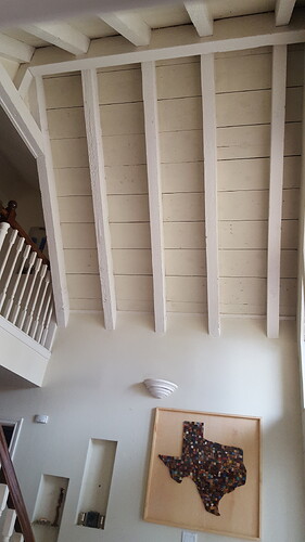

Will each fixture be hardwired into a junction box, or are you going to use track light with the fixtures suspended from that?
That’s the other tricky part. it’s an open beam ceiling. Wiring it in the first place will be interesting because i’m going to be going from a small (and horribly outdated) wall sconce. Basically I want to replace the wall sconce with this new lighting feature. I’ll try to remember to take a picture when i get home from work today.
I’m thinking of making a large plate to act as a bracket in between the light and the ceiling. Only thing with those pendant lights is that base plate. Might look weird to have 5 of those in a cluster.
i could try something like this. and separate them and maybe wrap the cord so it doesn’t look so plain.
Here’s what I’m working with.
