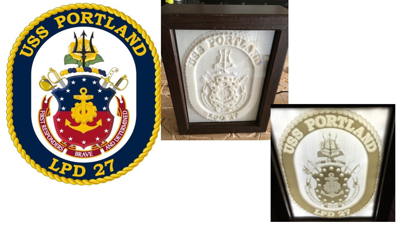

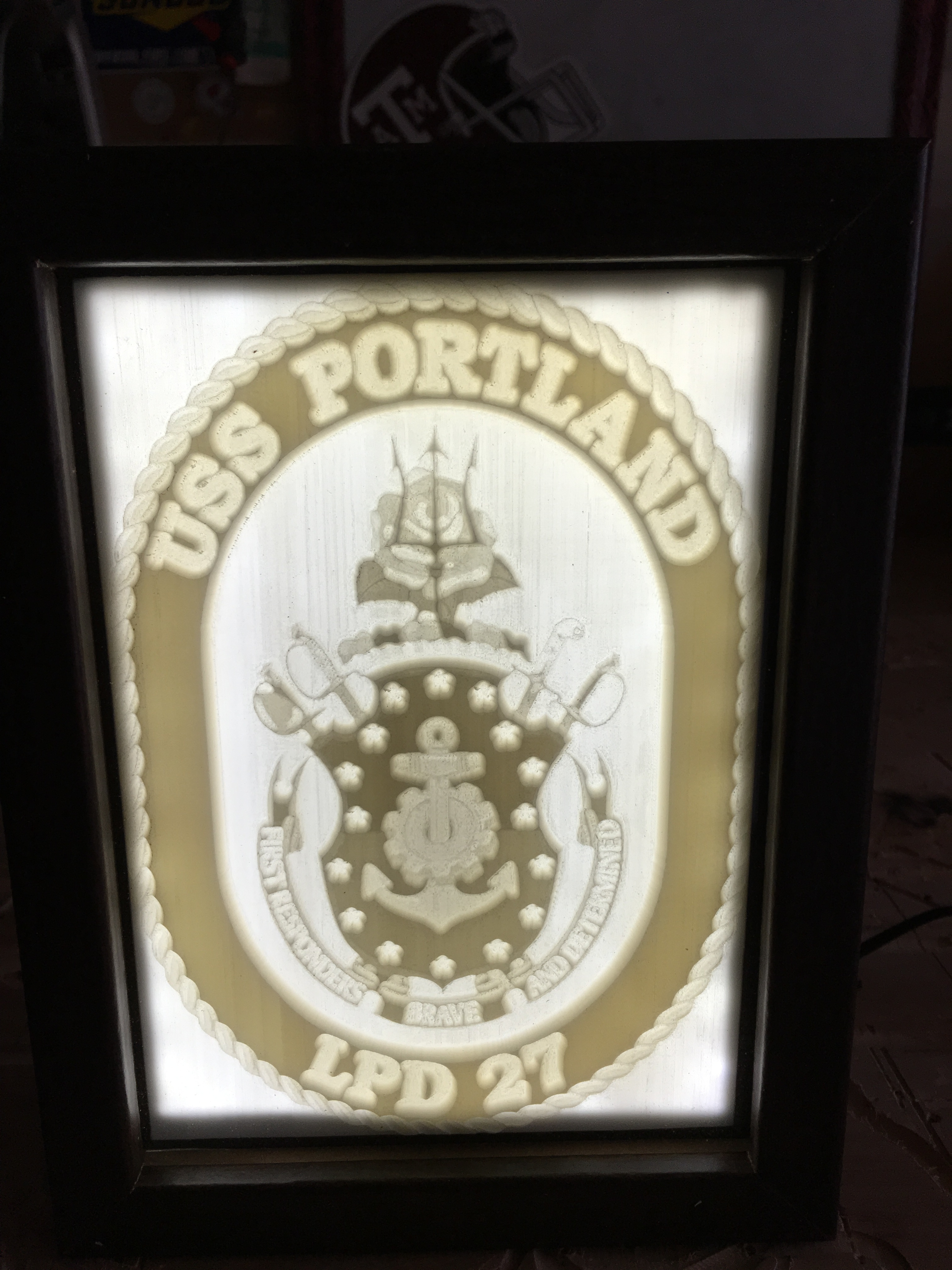

Completed a 11"X14" lithophane cut from a large piece of 0.47" thick corian. The backside cutout took about 2.5 hours with an 8mm bit and easel software. I cut the front with a 20 degree double ended bit using picengrave pro to generate the code (2.75million lines) and picsender software. The front took about 10 hours to cut out. I used 1/4" plexiglass as the light source with small lines of 0.05" dots engraved with my cheap Chinese laser. I had to use two pieces due to the limited size inside the laser. I used basic led strip lights along the edge of the plexi with a power cord soldered to the open end of the lights and a basic on/off switch installed. I use the light diffuser film roll sold by Inventables behind the plexi as well as a basic aluminum foil. To fill the open space of the 11X14 Michaels retail store frame, I use a 1" foam cut to size in all dimensions to ensure the items don’t shift. Total cost was about $60. Total time for the project was about 20 hours.
