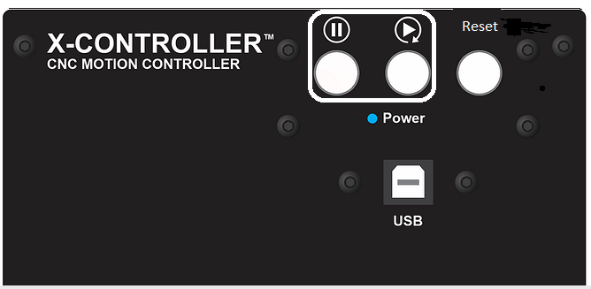

I was hoping to get feedback on the icons with my post. :grinning:
Yep, second set makes more sense than the first. Go for itā€¦ :grinning:

Personally, I am more or less indifferent. I think they both make entirely good sense, and look enough like the icons on most every other device and program to be quite self-explanatory. If I had to pick one, though. I think itā€™d probably be the second. Just a little bit clearer.
As an alternate thought, is it possible to put the names below them? ā€œPauseā€ ā€œRunā€ and ā€œClearā€?

For the button labels, my preference would be to keep it simple.
ā€œPauseā€ - for the feed hold
ā€œResumeā€ - for the Cycle Start
ā€œResetā€ - for the Reset
In my opinion the Pause, Play, Exit icons seem confusing. I would think that pressing the Play button would start a job. And that the Exit button would be what I use to stop a job.
If you want to keep the icons, It might be clearer if there was a box around the Pause and Play showing that they worked together. And then just use the word ā€œResetā€ for the reset button.
This I do like.

Just my 2 cents but if i had one of these awesome controllers the first thing i would do is tear it apart and anything that had a switch or button other than mains power would be rewired to a plug for a wired remote to mount for easier access. I think this is what i will be doing the first chance i get.
I like the Looks of the New Controller. It is hard to get to the power button.
If the 3 buttons on the front are going to control the cut and the Controller is going to remain On, then the power switch is ok. How hard would it be to make them color coded, Green - Start, Yellow - Pause, Red - Reset. I really like the placement of the E-Stop.
It would however be nice to have all the buttons on one side by moving the power up front and all the connections on the back by moving the USB to the back.
Not to change the subject, but the Arduino shield has the capability and should include the Pause Start/restart and Reset. Does anyone know if Easel has them implemented or is it a feature of the hardware?
@BillJutz The buttons are a grbl and hardware thing and will work on the gShield/Arduino if you wire them. It is a bit difficult because the signals donā€™t go to the gShield, you need to use pins on the Arduino.
Easel will be more compatible with the buttons in future releases. It works fine now, but does not give you status when you pause the job. In the future Easel will give you status and allow you to restart the job form Easel.
