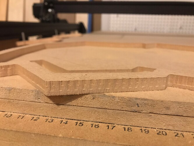

Loose belt(s)?
Hi there,
Does this look like a loose belt(s)? I didn’t use my Xcarve for a while. Thanks in advance!
Looks like z wheels, and dwell marks (machine stopping to change direction, too many nodes in drawing)
These are perfectly straight lines (SVG made in Illustrator, see attached). mpc-frame1-top
