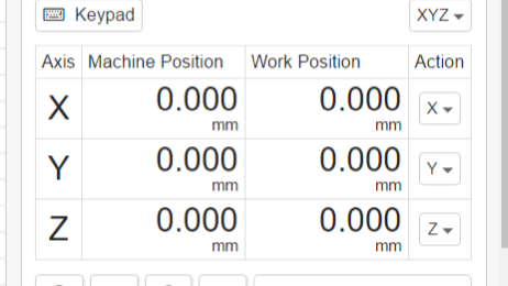

So this one was a bit strange. I had a multi-part job, where it did a 2 hour complex raster 3D roughing. I then swapped into the ball-nose finish pass, and in doing so of course slightly nudged the x-axis, so rehomed. When I did that I noted that the x-y zero was now waaaaaay up top right very close to crashing the top right corner. The homing worked perfectly and I had homed before setting the initial x-y zero to the bottom left corner of the stock piece. So of course optical alignment is almost impossible on a 3D carved piece since the original corner was gone anyway even if I wanted to (I should probably go to a 3-axis touch plate) to make this a non-issue, although the 3D carving does make the placing of a 3D touch plate hard).
Correct me if I am wrong here, but I should be able to rehome at any time [obviously not during a job] and it will not lose the X-Y zero (e.g. the offset from the machine XY zero to the WCS XY zero)? Or is that not true?

I use the little set zero button on each axis on the DRO in CNCJS I do each axis independently

@HenryFeldman, You absolutely should be able to home and return to the last zero set.
@HaldorLonningdal is right on here. Did you do a temporary zero (G92) or a permanent (G10L20)? Which version of CNCjs on which OS? Are you remotely accessing a pi?
I am running cncjs on Ubuntu 20.04 on a quad-core celeron based machine (so legit x86). I believe I am on the latest version. cncjs is running on a directly connected machine so no remote access, just have a monitor arm bolted to the CNC table, which I am standing in front of. The g-code is generated via V-carve pro (latest) with the x-carve post. But the x-y zero is done through cncjs’s UI.
Also what does temporary mean? How would the x-controller know I “finished” a job, I didn’t shut it off (I almost never do) so why would it reset the X-Y zero, and if it did reset kind of weird it picks a spot way, way up +X/+Y to reset to (rather than 0 offset from the machine coordinates…
So in looking at the console cncjs does a G10.
It seems to be working as expected for homing, so not sure what was happening…
