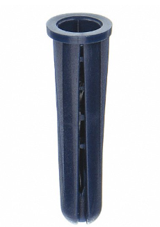

I wonder if you can superglue a narrow plastic screw anchor in there and then tap that for the original screw?
Thanks for the ideas, I’ve never done tapping and don’t want to screw (lol) things up but got this from Amazon just in case.
I like the anchor idea too, I think I also saw expanding springs that are machined to fill a slot and accept different sized bolts.
