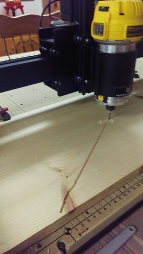

Hello All, I’m new to the group and hope I’m inthe right place to ask this. I finally got a chance to build my new 1000 X Carve and the build went very well. My issue is that when I start to carve it starts from the point I homed the spindle. I think I uploaded a photo of what the first cut looks like but there shouldn’t be any cut there. I can see the red line in the simulation and the blue is where the cut should be, but she starts from home point.
Any help here would be greatly appreciated.
Thank you

OK, that looks good. In Easel, open up the Machine Inspector (Ctrl-Shift-D) and check the Work Position locations. X should be 0, Y should be 0, and Z should be around 1.
If this is correct, there is no reason the bit should be driving into the material. We will need you to export the gcode next.
This is what it reads. I think the work position Y and Z are way off. How do I adjust those settings?

@JohnCastrovillari Can you get a video of the process from power on to just before you click carve?
Is it possible your Z is crashing / losing steps when it raises? It will “think” it’s higher than it is so it will move too far down.
Do this as a test. Run the Carve again, but manually set the XYZ positions. That is, put the center of the bit right on the end of the wood for XY, and lower the tip to just touch the wood on Z. Then click Confirm Home position. click the small X at the top to exit this screen, open the Machine Inspector, and the XYZ should be 0,0,0 if your bit is still on the corners and touching the material.

I did the homing manually and it worked like a champ. Need to find out why the probe didn’t work but I’m happy it worked and made my first cut. Tomorrow for some real wood. The test was scrap pine.
