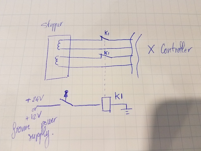

There would be a way to manually move your gantry but it would require some custom wiring.
The solution would be two wire one side of each coil through NC relays so, when the contacts open, the stepper’s coils would be open. At that point you would be able to move them manually.
I would use a key switch that control a +24VDC or +12VDC relay (whatever the X-Controller power supply is)
I post a quick hand drawn electrical circuit for one stepper (don’t mind the quality please :wink: )
I drew only one stepper but you would need to do that for every stepper. Either you use several relays controlled by the same key switch or you can find relays with a big set of contact control by the same coil that could cut more than one stepper.
I’m actually thinking adding such relays for mine too.
@RobertCanning It is a potential additional point of failure but by using NC contact, the failure will be when you want to switch in manual. If the relay burns the contact will stay close and you’ll keep operate as usual.

Are you hitting the “Pause Feed” button or the ESTOP button?
Hitting the pause button will stop the spindle and raise the Z. So you are probably hitting the ESTOP.
With the ESTOP engaged (no power to the motors), you can also manually turn the Z-axis.
