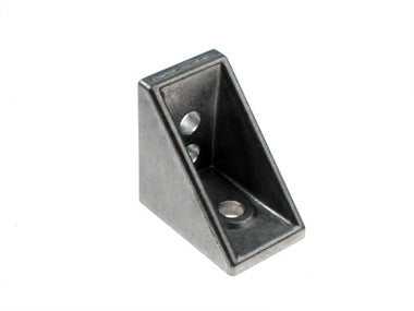

However, after all this time I’m noticing something. I’m noticing that near the middle of the waste board the cuts are coming out almost 0.02 inches too low, and not cutting all the way through the material. It appears that this is caused by the wasteboard ever so slightly sagging where it isn’t supported, since my machine is totally square and calibrated.
What do you think I should do? I know that unsealed mdf will sag over time, I just didn’t expect it so soon. I was thinking about putting a sheet of mdf underneath the wasteboard and bringing the machine up off the table by a mm like a topic I saw on here earlier, and I don’t really want an extruded alum bed as I like the screen printed wasteboard.
Would probably do the trick, and it is how the 1000mm version handles the issue. You could also use some M5 button head cap screws and a bag of T-Slot pre-insertion nuts, as well as a few M5 button head cap screws. The button heads can go in a few holes that are counter sunk by about 5-6mm in the center line of the waste board.
I’d probably go with Sketch42’s method, myself. Just toss another piece of 20mm extrusion under there for added support, looks like your table is beefy enough already that it’s certainly not the sag source! Alternately, if you have the rest of your wood shop already, just slap down a couple pieces of scrap maple or the like on your planer, and plane it down to 20mm.
It turns out I found a couple pieces of scrap acrylic laying around that added up to exactly 20.5mm, so I glued them together under the wasteboard and it totally brought the wasteboard back into square with the y-rails. Yay! And oh how wonderfully it cuts. Thanks everyone on the forums who have convinced me to upgrade, and @SamAlaimo who has been a huge help with stepper motors. I’m glad I upgraded everything on my machine, its gone from a hobby mill to futz around with into a reliable and insanely powerful beast that I can use for my business. Without this community the x-carve just wouldn’t be, well the x-carve !
