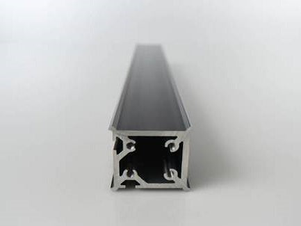

Upgrade size to 1000x1000
#1 - MakerSlide - 25142-11
http://www.inventables.com/technologies/makerslide
Description: Length: 1000mm, Type: MakerSlide, Color: Black Anodized, Ends: Tapped M5
Quantity: 2
#2 - Aluminum Extrusion (20mm x 20mm) - Clear - 26047-02
Description: Finish: Clear Anodized, Height: 20 mm, Length: 1000 mm, Width: 20 mm, Type: Extrusion, Color: Gray
Quantity: 5
#3 - Product: Wide MakerSlide - 30678-03
Description: Length: 1000mm, Ends: Tapped M5, Color: Black
Quantity: 1

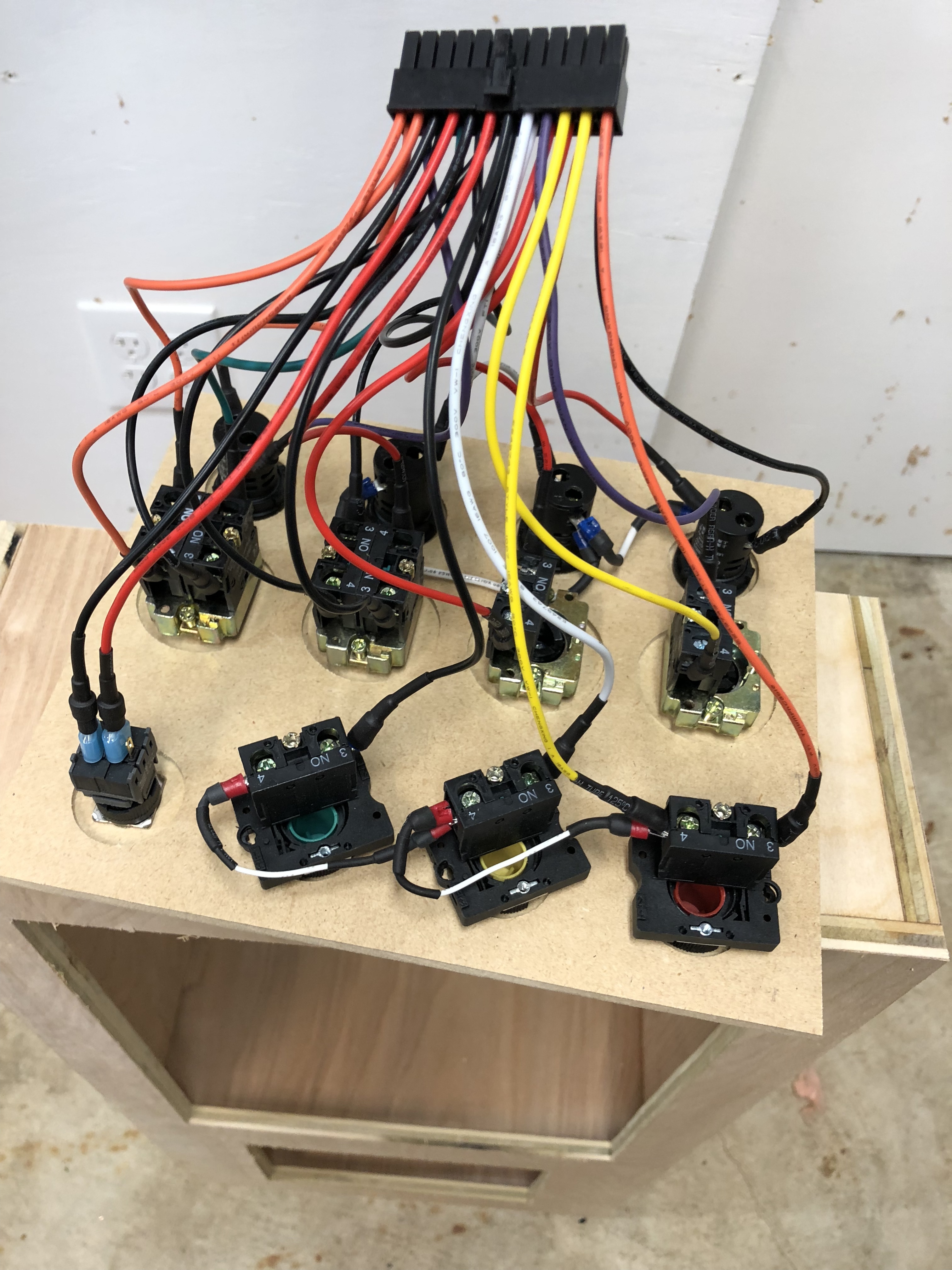

Button panel
#1 - 110v Power indicator
https://www.amazon.com/gp/product/B01EMYC6Z6/ref=od_aui_detailpages00?ie=UTF8&psc=1
#2 - Push Buttons (had to buy 5 packs to get colors and turn around times I wanted)
https://www.amazon.com/gp/product/B00RVAK1VU/ref=od_aui_detailpages00?ie=UTF8&psc=1
https://www.amazon.com/gp/product/B019DSZZ9A/ref=od_aui_detailpages02?ie=UTF8&psc=1
#3 - Switches - (2 way and 3 way)
https://www.amazon.com/gp/product/B0097B5V2K/ref=od_aui_detailpages02?ie=UTF8&psc=1
**#4 - E-Stop (Kind of small, would get bigger one)
https://www.amazon.com/gp/product/B075R8CTCK/ref=od_aui_detailpages00?ie=UTF8&psc=1
