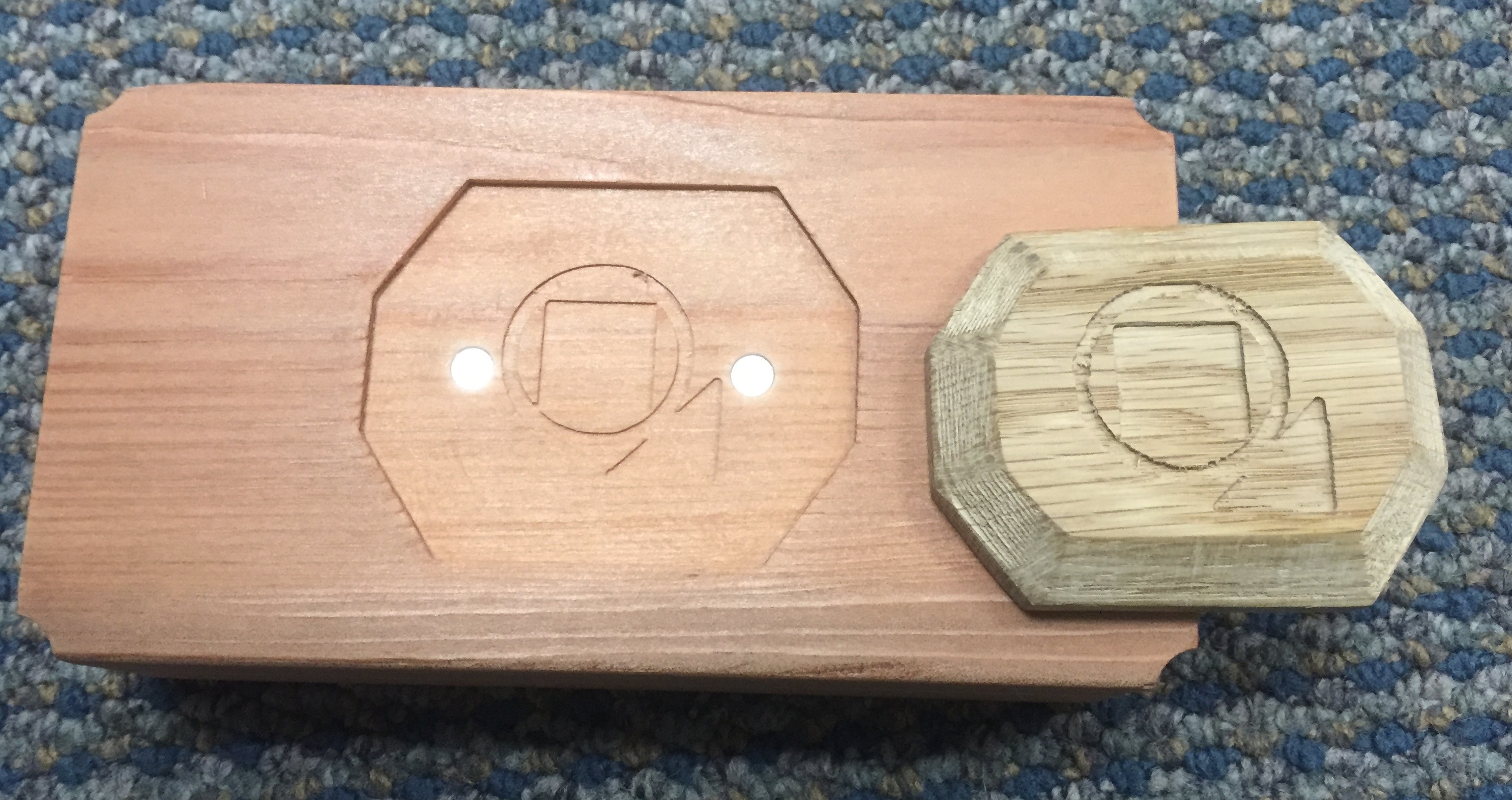

For this one I am playing with my idea as a “pendant” display box. Where the pended attached to a recess on the top of the box with magnets.

I did the final profile cut in climb mode to try to eliminate the chipping at the corners. It helps some but didn’t eliminate it. I guess redwood is just to soft for this kind of corner. (Maybe a rounded corner?)
I think I will stick with hardwood for boxes when I can, and modify my design to work with 4/4 planks (regular .75 inch planks)
For this particular project the box is just a bit too thick. I may go with a hinge as well.

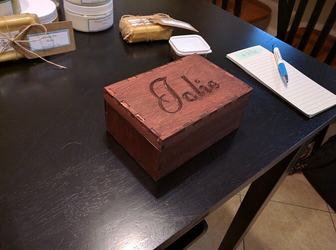

I didn’t think it worthy to start my own thread on the boxes I made, But I made a couple last night and now that I’ve designed them, they really only take about 15 mins to cut out of some 0.2" plywood (you could obviously substitute any material, just adjusting the finger lengths to fit accordingly.
