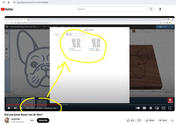

How to share an easel project is shown in the 2nd half of this > https://www.youtube.com/watch?v=qX9gEkbX0v4
the cut types are in fact the same and bear the same names.
If some of the cut types are not allowing you to apply them to your design this is usually because an OPEN design has been imported, rather than a fully closed design shape. IF you CLOSE the shape than all cut types will be allowed.
You’re right, that’s why in the video I did not do as you’ve described, I use the offsetter V2 app.
In fact, here’s a screenshot of the timestamp and I even labeled that section of the video accordingly…
you’ll actually want to use the app called “offsetter v2” not the original one without the “v2” and this is also shown in the dog tray video…
Now My questions> Did you import an Image or a SVG/DXF?
…If importing an Image I highly suggest converting that into a SVG prior to importing (the video referenced in the opening of the dog tray video shows how I convert images into SVG’s using inkscape , it does a much better job than Easel does, but there are more steps to get it looking perfect.)
…If importing a SVG/DXF than it would appear that, based on some of your comments, that the imported file was not properly set to automatically CLOSE the shapes when the SVG/DXF was saved, and this could be the root cause of your issues with cut paths…

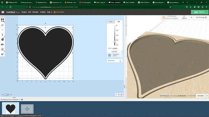

Fill is going to give you a full shape, which should want to create a pocket of the whole heart, which is what you want.
Outline (on path) will give you the shape and the vector will be based on the line of your path. Choosing this option means that it will not cut the whole heart as a pocket, it will just do the outline.
Outline (outside) will give you the shape and the vector will be outside of the path. You might choose this if you want to have text inside the heart, this way the heart can stay away from your text.
Outline (inside) will give you the shape and the vector will be inside of the path. You might choose this if you want the heart to be inside of another object.
I’m sure that there are good reasons for each of these options, but I really only use two. Fill, and Outline on Path. Everything else I can control and I can change it later as well (which hopefully you will see and understand here as I continue).
When I choose Fill, it creates a shape which I can size up, and it is already set to Clear Out a Pocket, and the preview window shows what I want, I just need to choose a depth. I have changed the depth as you can see, just so that it gives a clearer indication that it is indeed going to clear a pocket.
Something to note at this point is that the dark outlines means that is what is going to get carved. Anything that is white will not. Simple black and white images are pretty easy, but if you start importing colored objects (which will be converted), sometimes what you want to not get carved actually will because the color indicates that it should. You can select areas and change the cut to outline. This may be confusing right now, so I will see if I can come up with an example to show you what I mean, but for now I am just going to stick with what I believe you are looking to do.
Now, at this point, I am going to add something because I believe (or at least what I think from what I am reading), is that you would like an edge. As if you were to make this heart like a bowl, for lack of a better description. This is what the Offsetter app is for.
Here is an example of what I am talking about, sort of. This heart has a curved edge, and what I am explaining to you here is going to be sharp edges, but I think it is still the general idea you are looking for.
Click on the heart to select it. It will show you a bounding box around the heart (that’s the lines with the squares for stretching or shrinking, etc). Pause for a moment here and bear with me, because this is important. The first thing that you need to do is go to the Cut (and Shape, but select Cut) toolbar, and change your Cut Path to ‘Cut on Shape Path’. Yes, this is going to change your carve and your pocket will disappear. Bear with me. Now with your heart ‘outline’ still selected, select Apps from the toolbar (Lego piece) and under Utilities, you will find Offsetter, and two icons below that you will find Offsetter (v2). Select v2.
It will ask you for some options and show you a preview of what it will look like. Distance is the amount that you want for an edge. I am just going with a quarter inch edge, so distance is 0.25. I want 1 Iteration - just one edge. You can make it go inwards if you want, or if you need to stay within your workpiece or other objects. I am choosing to Keep Original, because I do want the two lines of the heart. Import.
So now you have essentially two hearts, one inside the other. Select just the inside heart (not select all), and go back to the Shape and Cut toolbar, and select the Cut Path as Clear a Pocket. Now you should have two hearts, one cut as a pocket, and one as an outline.
Now select just the outside heart (not select all), and set the depth slider all the way to the bottom to do a through cut.
Now you should have a heart shaped bowl, which is what I believe you are trying to achieve?

after several fails and disasters, I ended up with a heart shaped bowl with carving inside (it was suggested that I do not trust the software and machine to do that lettering carve at the bottom of the pocket based on surface measurements (ODD to say the least), and instead I did this project as five separate projects, measuring from the bottom of the pocket to make that carve.
in the end, I got a heart-shaped bowl with carving at the bottom, and discovered in the process that there is much work to be done in easel on the part of the designers before such a project could be mass produced for a profit (no project that requires five separate carves to complete could ever be profitable), so for the time being, I will abandon this project as a potential income source.
