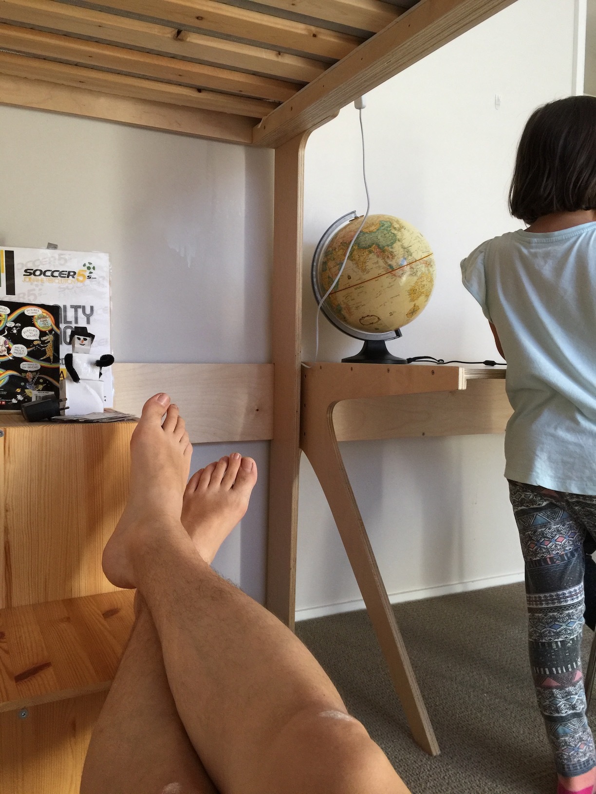

My biggest and most ambitious X-Carve project ever! (Completed)

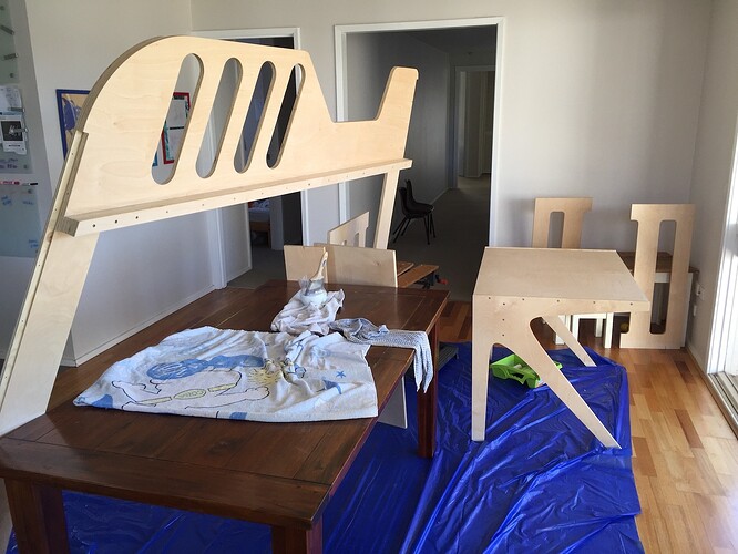

Finishing in a water based satin lacquer.
Three coats with two hour drying time in between, did the top of things then the bottoms the next day.
The top of the desk received five coats.
Two days with furniture bits in our kitchen/dining area. The other side of the loft bed is still in the study because I couldn’t fit everything in the one room.
On the last day I could fit everything on the table because I only had to do the bits that had been touching the ground the day before.

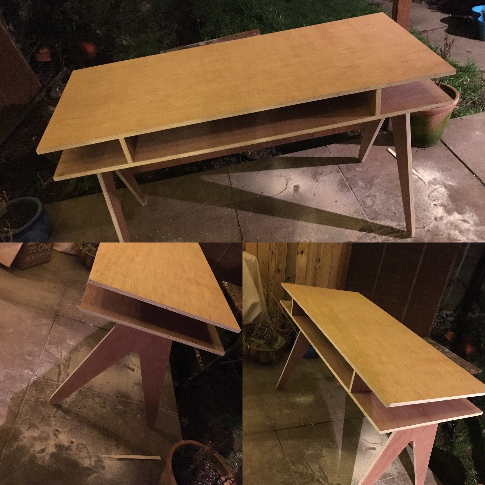

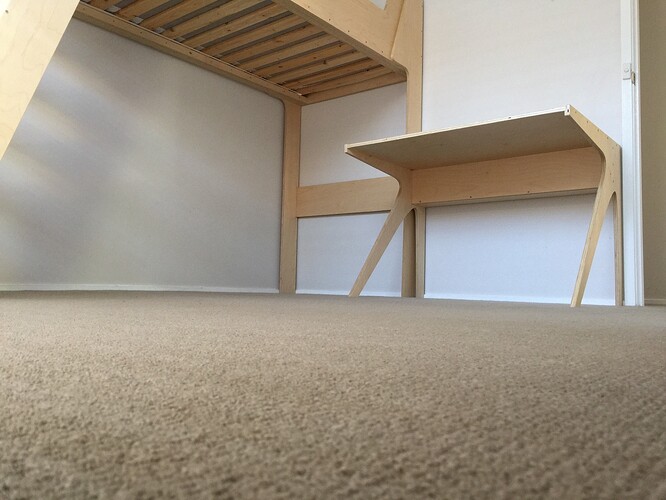

How is the desk design for side to side movement?
I made this desk with my X carve and it was brilliant front to back but side to side it wasn’t great. I ended up adding diagonal bracing to stiffen things up.
Oh! nice desk!
Mine’s not great for side to side movement either.
It may end up being held onto the loft bed. Or maybe a set of drawers stuck between the top and one side as a form of cross bracing.

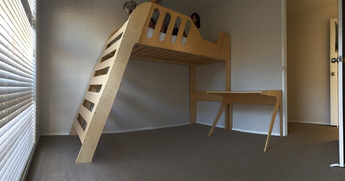

And now for the conclusion …
Test set up and assembly in the study:
Panorama of the assembled pieces in the bedroom, the dog is not that athletic, I had to put him up there.

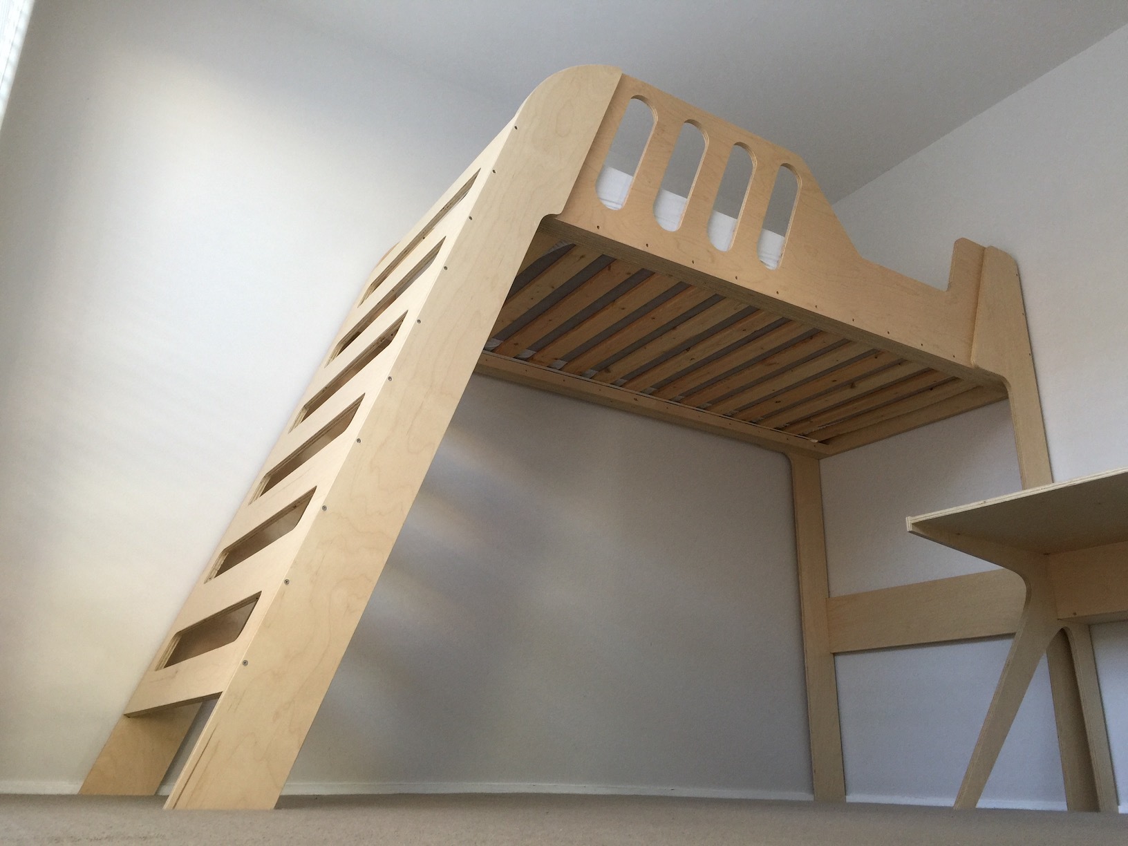

DRAMATIC SHOTS!

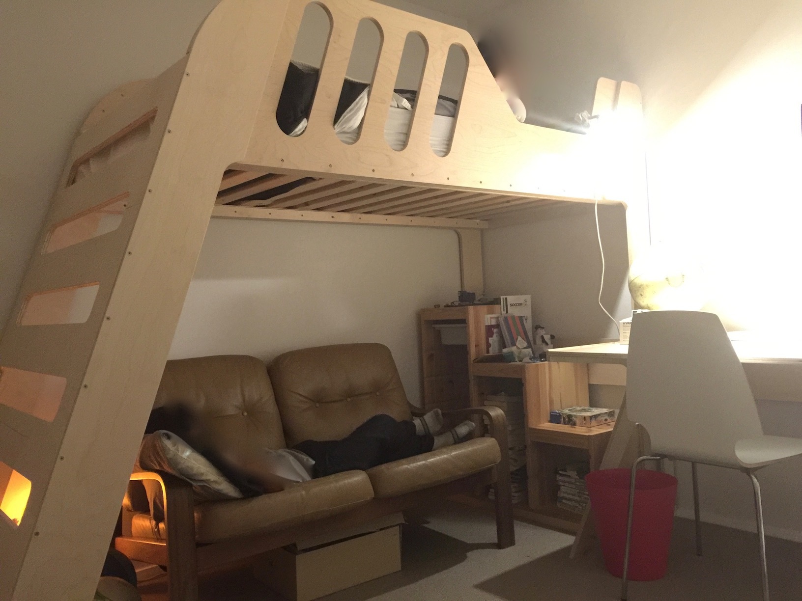

The view from under the loft bed, it’s a nice spot for reading:
The final step is re-introducing the mess that was removed earlier.

How’s the little one liking it?
He loves it!
Before trying it he didn’t want his old bed sold for a while, now he’s happy for it to go. So that’s a success! He reads on the little sofa a fair bit too so it’s good to have that space there for him.
In the end, that’s all that matters right?

Hard to tell/cant remember… did you round over the edges of the steps?
Thanks everyone!
I haven’t rounded out the edges of the steps, and they are … not pleasant!
I will soon make some little pads to sit on top of the steps.
