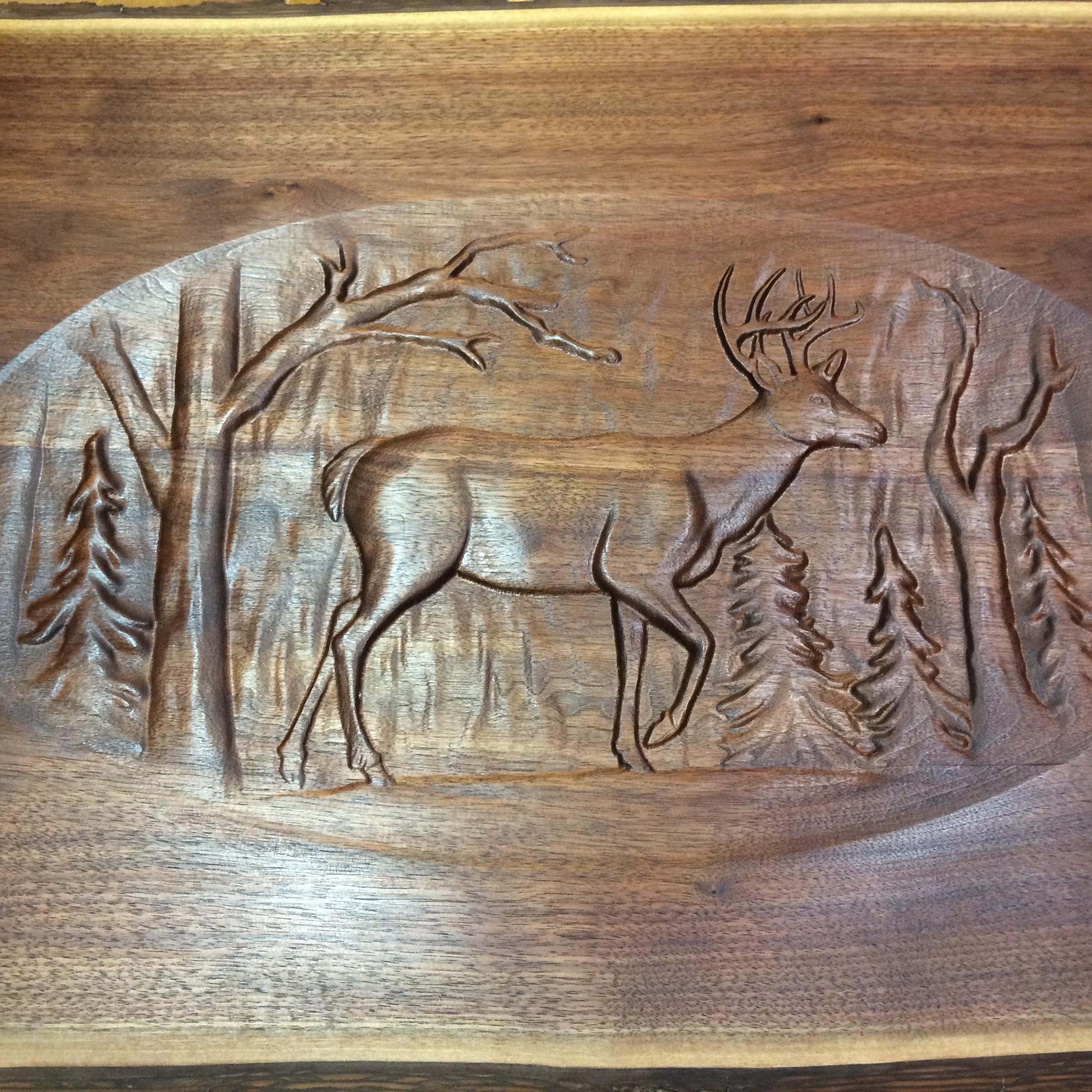

I have found that sometimes using a smaller ball nose is not actually better for surface finish. Especially if you do not have very fine details. If you have access, you might try an 1/8" ball nose. Here are some examples of what I have done with an 1/8". I have a 1/16" ball nose but I have never used it. I did very little surface sanding on these, just a bit of hand sanding with a 220 grit soft sponge.
@BlairHarp Holy moly! Yes, I do have an 1/8" ball nose. I will definately have to try using that exclusively. (It would certainly make things easier as the pass one pocket clearing was performed with an 1/8" ball nose and then I wouldn’t have to change bits for pass two.)
What step over do you typically used on your carvings using the 1/8" ball nose?
On all of these I used a 10% stepover (.0125").
