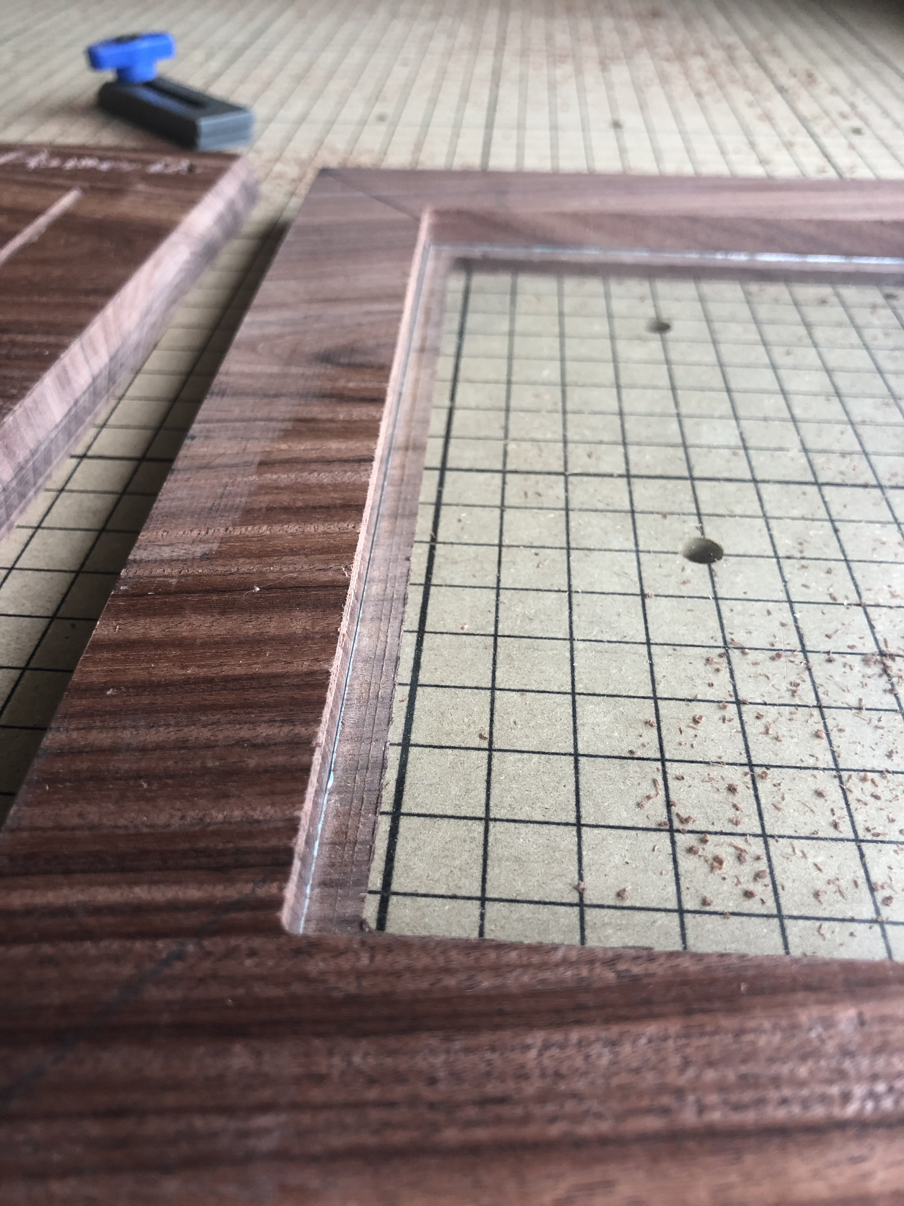

Made this for my mom for Mother’s day. The kid calls her ‘Noni’
The only difficult part i had was notching the back side for the glass and picture to fit into. I cut down an 1/8 inch on the front side where the picture is and then turned it over and cut down 3/8 inch for the inset piece and all i had to do was razor the thin bit of material left. worked great! I’ve got pictures on my phone, I’ll attach them after this post
