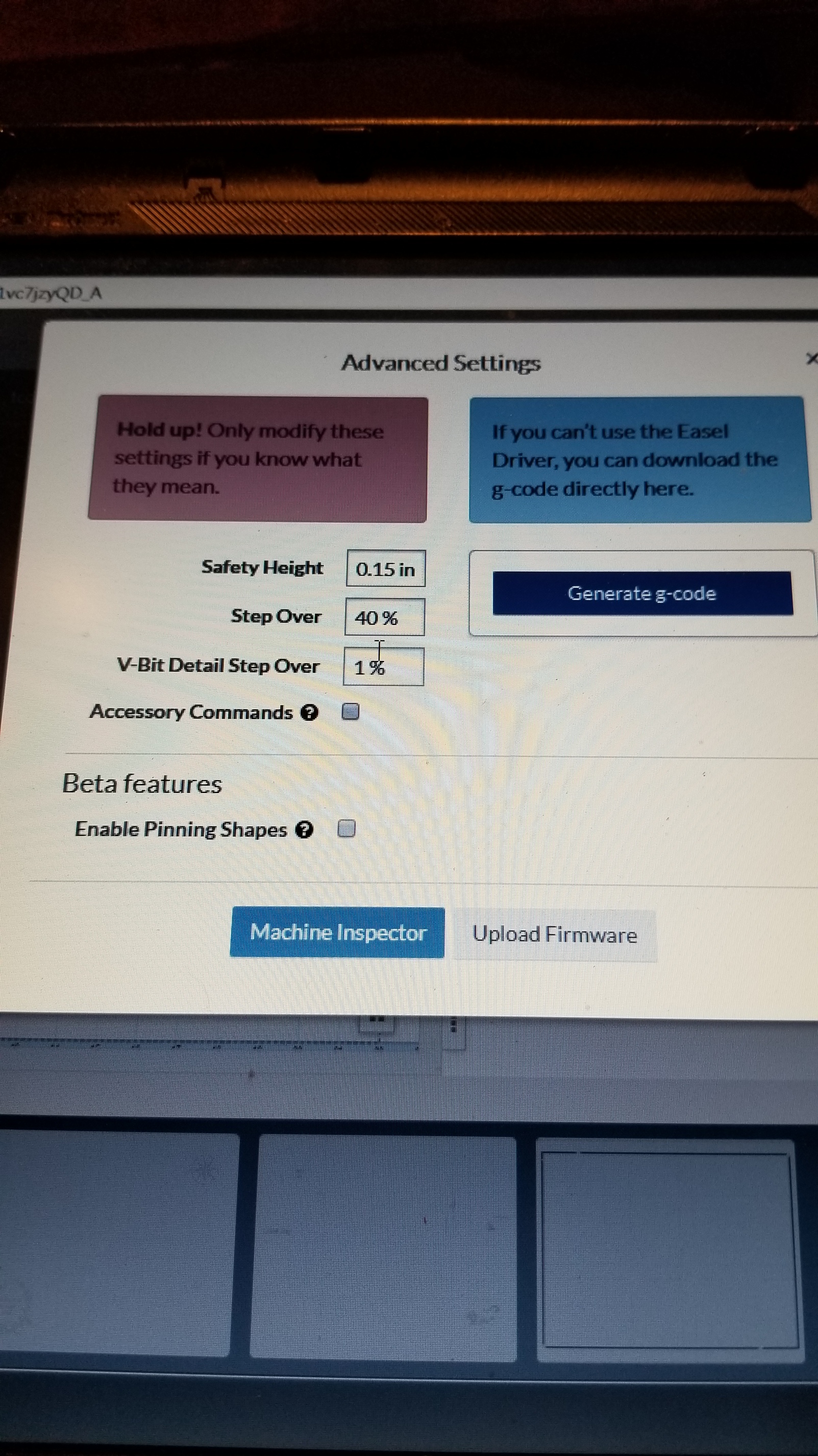

I am not happy with the quality of my lettering after using easel for a few months… It’s me I’m sure…
I use Vbits, mostly 60 degree but sometimes 30, 20 and 15 depending on how small the lettering is and how detailed I want it to be. Even with the 60 degree vbit its not smooth and there is a lot of burs and crap that I need to dremel out. When I dremel out it inevitably can impact the quality of the original cut.
I have the crossover set at the standard 40% and it doesn’t matter what material I use, Maple, Oak, MDF, Poplar… the lettering just comes out messy.
I check the surface of the material each time to ensure it is flat and I run my boards through a planer before glueing them up. The Xcarve is flat as well and I check that daily.
Suggestions? Thanks

  1. The touchplate is set with the machine setup, I just checked but will do it again before my next carve.
  2. Where can I find more info on steps per mm? I attached the screen shot of the advance tab in Easel…
  3. Screws are all tight
  4. Wood is planed before each run and I also check the wood with a level before and I after I clamp it down.
the machine setup can not calibrate the touch plate. it can only install the default perimeters for a touch plate. this tells the X-Carve that you have a touch plate and would like to use it.
if your plate is not exactly the same thickness as the default setting, (very unlikely that it is) then you really should measure the thickness of the plate you have and manually enter that into the setup.
as far as calibration of the Z axis, when you tell the machine to move the Z 1mm does it actually move 1mm or is it 1.5mm or .7mm etc. etc. for this I recommend a dial indicator but you can use a caliper of ruler but they are not as accurate.
Take the bit out, jog the router as low as it is allowed.
Place a ruler next to a good reference point and jog the router up say 50mm, is the actual movement 50mm or it is say 48 or 51?
Report back and we can suggest what to change.
The values governing the calibration is within the GRBL-parameters, you call them by typing in “$$” and hit ENTER in the Machine Inspector / Console window.
