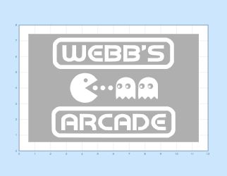

So, I am currently making a small sign as a test run and my carving is shifted to the right and up from where it shows on Easel. I set X/Y zero to bottom corner of the material, used my z-probe and when it started carving, I could tell right away that it wasn’t carving where I wanted. Luckily I had intentionally left space around the border to serve as both a place for the clamps and also to act as a border as the project has an inlay. I actually had to pause carving, turn off the spindle and remove a clamp, otherwise the bit would’ve chewed right through it! I am still letting in finish, as it does have wood to work with but it’s not at all centered.
Hopefully someone can tell me what I did wrong! I am a newbie so forgive me
As for setting zero. I move the spindle manually (jog) over to the bottom leftmost corner during the pre carve routine, as instructed. I use my touch plate as well at that point. Do I need to change the setting where you can choose home location with the 5 dots? I am fairly sure I have it set to bottom left.
To clarify, bottom leftmost corner of the material. Also, does it matter where on the wasteboard I set the material? As long as I set the X/Y zero, it shouldn’t matter right?
Ok, I can see the project now. So, you’re only off by .25" - .375" or so? Did you set zero with the very tip of the V-bit over the very corner of your stock? Small discrepancies like that can often be due to setting zero with the bit “inside” the corner.

Work zero can be anywhere within the reachable space of the machine. Work zero must correspond with the XY0 point in Easel.
Default is having work zero at lower left corner of material, then the bit must be centered above the lower left corner of the design. If the is space between design and XY0 point in Easel the deisgn will carve offset.
If for instance you want to set work zero centered over the design, then the design must also be centered over XY0 point in Easel.

So, here’s my progress. I have changed the project to do a 2 stage carving, the rough carve with a 1/4" endmill and the detail with a 1/8". I am using actual wood, not plywood this time.
I was very hopeful as it looked like it was going great! The rough pass only took 9 minutes and the detail work took over 2 hours, maybe closer to 3, I didn’t pay attention
Once done, I saw that it looked like it still had work to do, there are pockets left and the eyes of the ghosts, for example, were not completed. Any idea what went wrong?
I see you changed the 1/8" detail bit to a 60 degree V bit. Good choice.
The 1/8" bit was to big to get into those areas.
Now the reason that I think that it left material where the bit could reach was you didn’t set the Z height for both bits in the same spot.
When doing a 2 stage carve make sure you remember where you set you Z at because you have to go back to the same spot and it has to be a spot that the roughing bit will not touch.
It looks like you had room to the left on the sign to set your Z.
