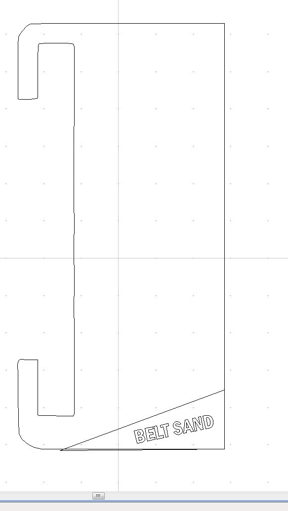

Name Plaque holder
I am trying to create one of these.
Its complicated but I do not need it to be this fancy. Just practical for creating it out of wood and slotted for the name plate that slides into it.
Any ideas how I can create one of these on the X-Carve?
I do have a bit to do the slots. however I would have to maybe do it in 2 parts and join them is what I was thinking.
Thanks

As others have said, a CNC has limits and often isn’t the best tool for a job. If you have to use it though, one way would be to make a shape like this:
… then either cut out a WHOLE BUNCH of them and laminate (glue) them together or just cut out 3 or 4 of them and connect them with wood dowels or thin pieces of wood.
This would be a redesign, but I think it would look quite nice in wood.
Could you create it in three parts? First being just the “tray” section that the name plate fits into. The other two would be clips/stands that sort of grasp the nameplate to the tray while also acting as a support structure.
Clips something like this:

Quick Idea, do it in 3 sections, 4 (or more) parts
The frame rails, the back piece and the stand leg(s)
Here is a very crude easel sketch up:
The “rails” are glued down and the back legs glued and or screwed with countersunk holes so the name plate can slide over.
As an option you could carve into the back support so there is something there even without a name plate.
You could easily make this with traditional tools, but the point isn’t to just make it. But to make it using the XC :wink:
Gluing together a lot of profile cut pieces is nice if you find a wood with a good end grain. One tip is to put a hole in the cross section so you can line them all up on a dowel. It makes the final alignment much easier.
If you’re good with cutting those slots, hollow out the rectangle first, then cut the slots. Then sand the base to give you your angle. 1" thick material should provide plenty of angled base to support the piece. You could do four at once out of a long piece of 1" thick wood. Cut them down to the appropriate length. Then, you can round the back top corner as well or even grind it down. Here is a bad pic of what I am talking about.

Just wanted to see if I could get that slope down the back after flipping it and angling the part enough to get a rounded bit in there to cut the rest. I will have to come up with a jig. I wanted to know what others have done. Usually gives me a good spark of an idea.
I will post how I do it later.
